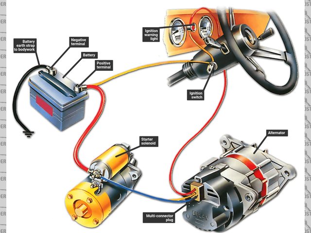

Be careful with that ignition lamp. I was doing a rewire of my dash and striped all the wires off the tell tale lights without taking photos or drawings. Got sidetracked with other jobs and went back to dash a year later. Wired up the way I thought it normally should be, i.e. +ve to the centre post of the bulb and -ve ground to the bulb holder. First time I went to start the engine, the loom melted all my earth wires in my loom.
I was Sierra pinto, with a butchered Sierra loom. Blue wire from alternator to the centre post of bulb and a switched live to the -ve post of the bulb holder if I remember correctly.
I found a good diagram, I will try to post if I can find it.
This one, but wire from my alternator was blue and not red as per photo. Hope this lets you see how it's wired
ign tell tale wiring
