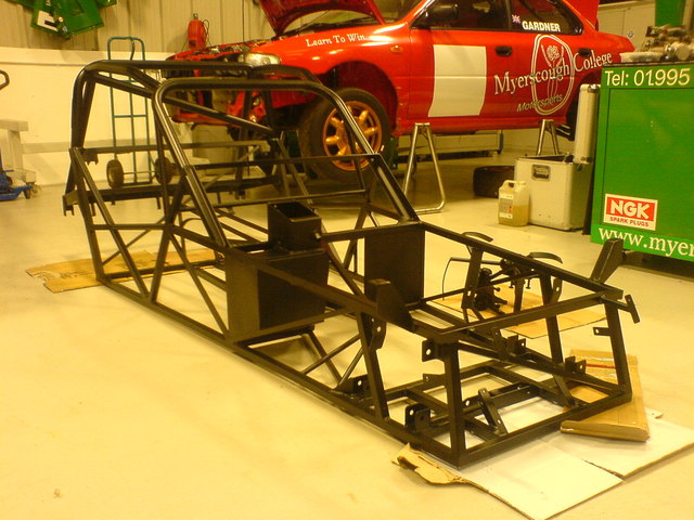

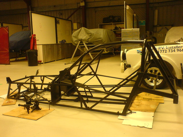

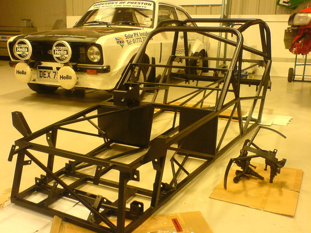

Just thought I'd post a few pics of my Sylva Striker's new cage fabricated by Protection and Performance near Barnoldswick in Lancashire.
