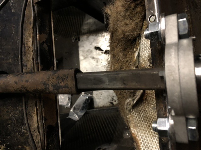

Hi folks
Iím struggling to find a source for the white plastic triangular bush that fits within the telescopic part of the Sierra steering column, mine has all but disintegrated as can be seen in the photo, help appreciated.
Steering bush
Steering bush
ReMan
posted on 3/1/20 at 07:40 PM Reply With Quote
I suspect that may never have been available as a spare part.
But that should make someone come along with a Sierra parts cat and prove me wrong
Here's hoping.......

big_wasa
posted on 3/1/20 at 07:46 PM Reply With Quote
I am also sure it was a non service item and never available.
I would say your best bet is a replacement column.
I want a set of non adjustable shrouds, I bet there even harder to find...
[Edited on 3/1/20 by big_wasa]

Non serviceable was my concern...
I have two alternative approaches; 1. Brute force- use a punch to collapse the outer tube to grip the inner bar, 2. Techy- a friend has a 3D printer and loves a challenge.

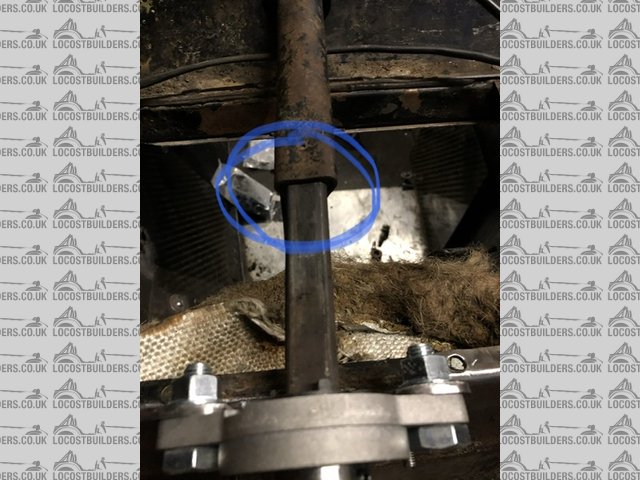

Thatís neat solution, but for a different part of the column, the bush Iím after is further up
Steering bush 2
Steering bush 2
big_wasa
posted on 4/1/20 at 09:00 AM Reply With Quote
I was going to say I think it's this bush your after as the other one is still available from multiple sources.
big_wasa
posted on 4/1/20 at 09:29 AM Reply With Quote
What about making some shims up and plug welding them to the inner.
Will still allow it to slide.
voucht
posted on 4/1/20 at 09:55 AM Reply With Quote
Steering bush 2
Steering bush 2
Ah OK, sorry about that...

fregis
posted on 4/1/20 at 01:28 PM Reply With Quote
Go for 3D printed, easy to make and will hold.

Mopple
posted on 9/1/20 at 06:25 AM Reply With Quote
I used countersunk alu rivets for fixing the telescopic bushing. With some sandpaper finish and grease the telescopic function worked a treat.
