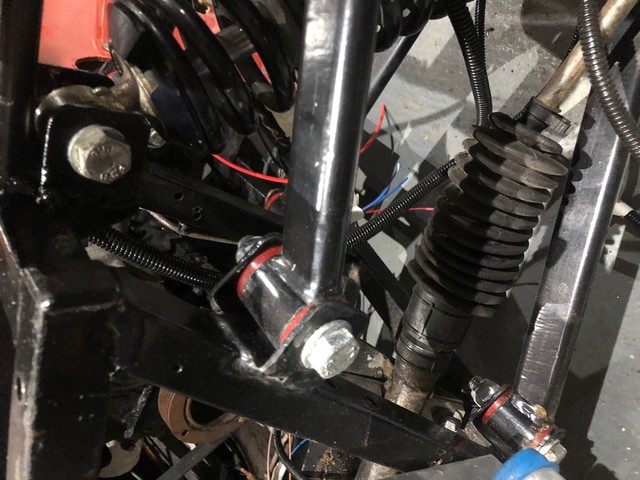

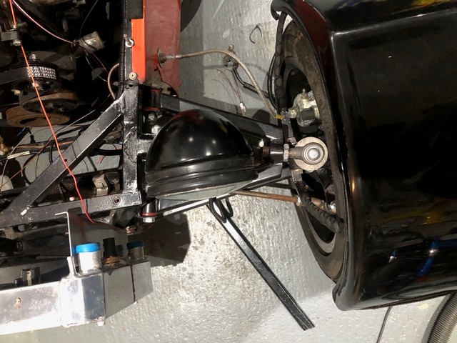

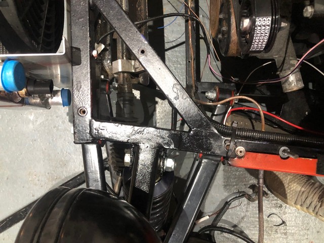

From looking at your chassis, I’ve noticed your front wishbone fixing points are offset. My are offset but my wishbones are not designed to be offset, as my front wheels seem further forward and my steering arms are further forward. I’ll add photos tomorrow for reference
macboycie
posted on 11/1/21 at 10:16 AM Reply With Quote
Added photos for reference
[img] Description
[/img]
[img] Description
[/img]
[img] Description
[/img]
Measurements
Rear lower 410mm
front lower 335mm
rear top 610mm
front top 560mm
Can I buy offset wishbones or do I need to space out the front

Things don’t look right. Best to get it stripped down a bit and in the day light for some better photos.
