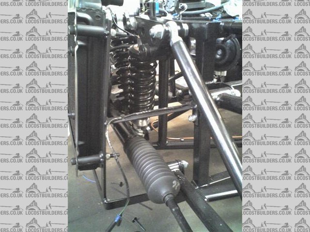

I made mine out of steel tubing (12mm o/d I think) not very good pic with camera phone:
