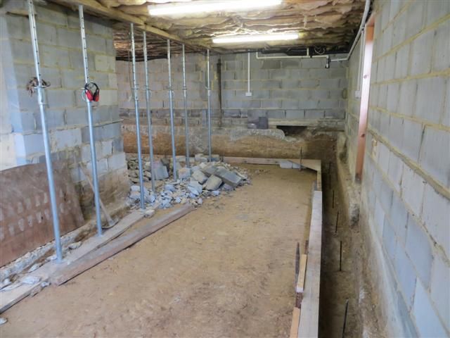

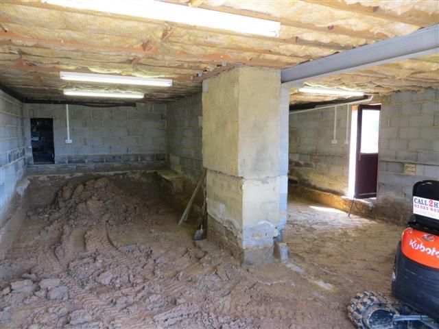

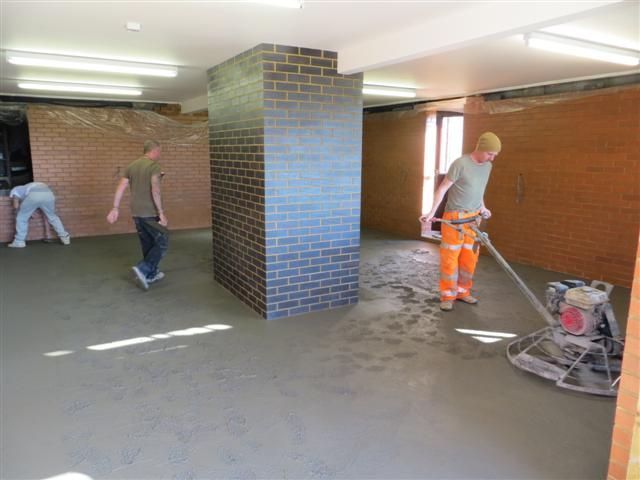

I,m in the process of doing this, about to go away but will post up pics on my return.
Dug out under house going back into hill. went as far as the base of the original foundations. new strip foundation with a new skin wall within the
old one.

posted on 2/11/15 at 06:43 PM |
During excavation.
[/URL
[URL=http://s1180.photobucket.com/user/southernkitcarclub/media/Kentons/IMG_0258%20Small.jpg.html]
As of today
[Edited on 2/11/15 by kenton]
smart51
posted on 2/11/15 at 07:03 PM |
Cool! I take it the original depth was where the block work changes.
kenton
posted on 2/11/15 at 07:27 PM |
Yes, about halfway up you can see the damp course.
steve m
posted on 3/11/15 at 10:05 AM |
Is this the new SKCC clubhouse ?
looks great, and wish I had a void under my house like that !!
