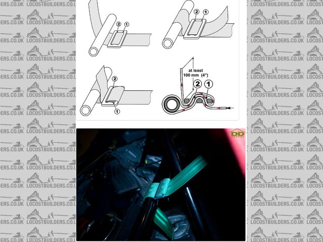

907
posted on 25/8/17 at 11:14 PM Reply With Quote
I have just fitted a harness like that in my MX5
The roll bar has a welded in harness bar and I used the buckles as in this diagram I found.
I believe this is an acceptable way to fit them.
