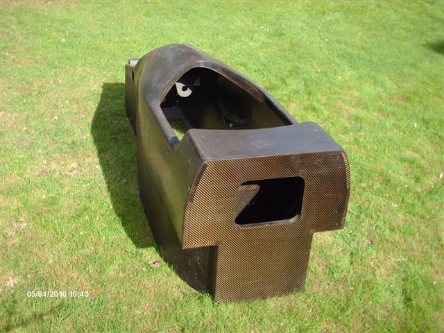

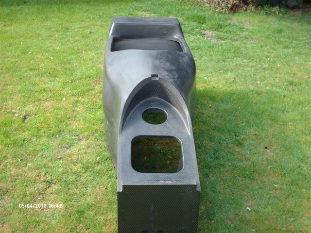

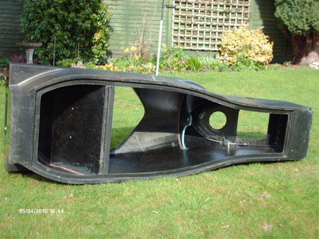

It's a carbon-fibre single-seater monocoque that was designed for use in Formula Vee. Unfortunately the regs were changed and CF chassis were banned. Their loss... my gain!

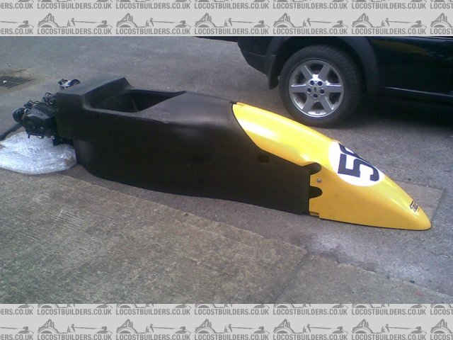

This is what a finished car looked like (minus the nosecone / rear cover):

The rear bulkhead has an ali honeycomb insert between the CF layers to provide extra strength. I'm thinking that my rear subframe will attach via top-hat inserts (so as not to crush the CF / ali honeycomb panel) and clevis-mounts. This is similar to how the VW engine was hung on the race-car:

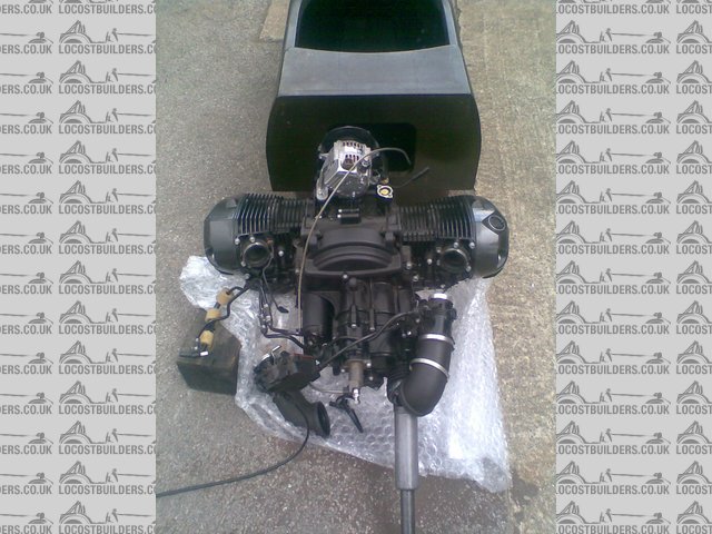

Engine!? I always wanted to use a BMW Boxer twin as it lends itself to a simple installation (no radiator / plumbing), they're light (and that weight is all low-down), and it has a shaft-drive (low maintenance). That said, the 60-100bhp figures were rather underwhelming. So I searched high and low for the 120bhp R1200S engine only to find that they're few and far between and when one did pop-up, the prices were just ridiculous. And then came a miracle, not an R1200S lump for sale, but the holiest of holy's... the even more elusive HP2 Sport engine! What's more, it was sensibly priced! Get-in... 130bhp, 85ft/lbs and only 45kg! Game-on!

Now you are really on the right track! Looks like this idea is a real go-er.
Light, easy to get high front roll stiffness, easy engine install. You will need to watch wheelbase don't get too long but I'm sure you will overcome that.

btw, the picture of the c/f tub in the first pic (without many scale references) makes it look like a lightweight prop tunnel/centre console

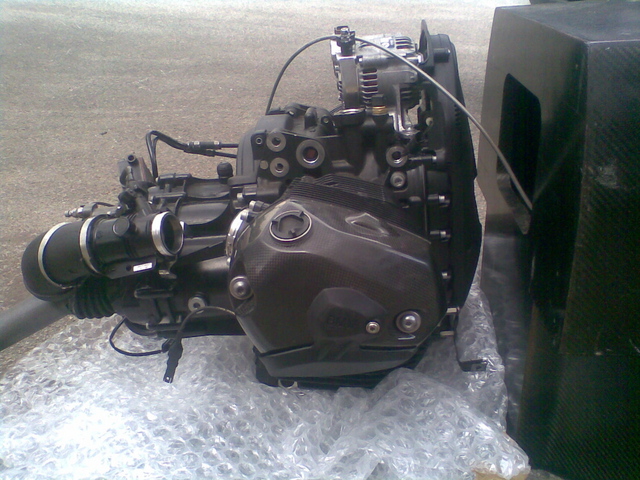

Just back from a trip down south to fetch the Beemer engine (Leicestershire, then Nottinghamshire to drop it off and then back to East Lothian). Been on the road since 4am... knackered.com!
Got to sit in the carbon tub and make 'broom-broom' noises! Loads of room in there... even for an adonis like me!
Not had a chance to weigh it yet, but I can lift it with one hand!
First time I've seen all the bits together and I'm really pleased. The engine may be an airhead, but it sure looks swish!

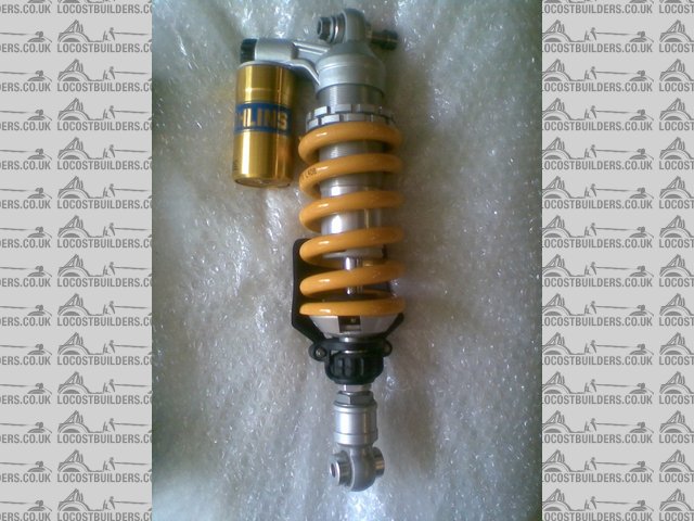

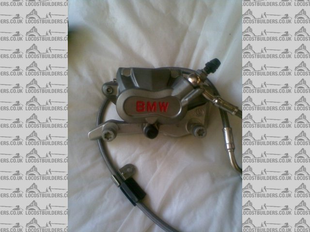

Got my rear shock and brake caliper today!

There are ali honeycomb panels sandwiched between most of the CF layers in the back-end to add strength and rigidity. The roll hoop bolts through one of these.

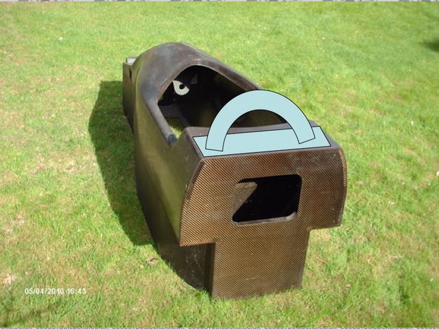

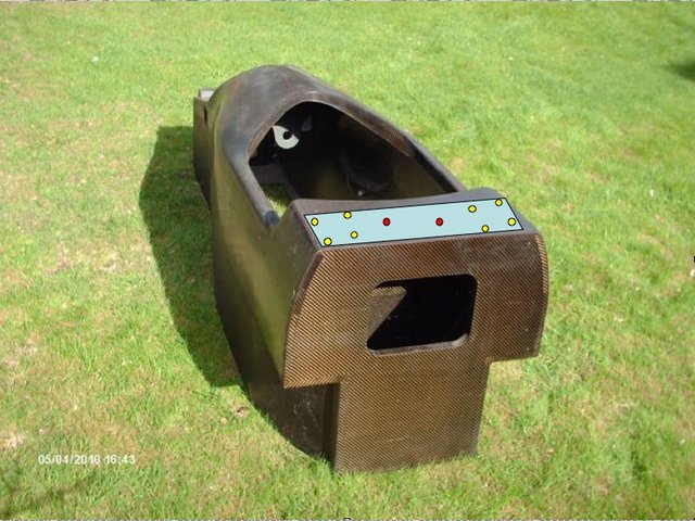

Thinking about the roll-hoop assy.
I'm going to have a stainless plate with a T45 hoop welded onto it. Can anyone suggest a thickness for the plate and a wall thickness for the hoop?
The plate will be fitted using 8 bolts (yellow dots) and 2 harness bolts (red dots).
alistairolsen
posted on 17/7/11 at 09:49 AM Reply With Quote
either 45x2.5mm or 50x2mm as recommended by the MSA.
I wouldnt use stainless for the plate and have a mixed metal weld on the base of my roll bar hoops either, do it all in steel and powercoat it.

Why not duplicate the lovely CF thing in your previous photo?
It wouldn't be a 2 second job, but it could be done
