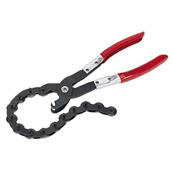

No grinder needed, there is a chain type tool for cutting exhaust pipes
Clamp it on, rotate a few degrees each direction, tighten and repeat.
[Edited on 11-12-19 by ken555]

hat is what I think they used on our car.
