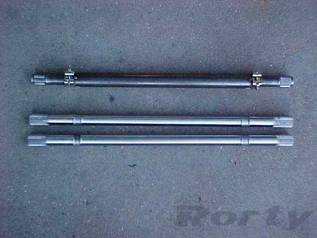

I once read that the best way to shorten a shaft is not to cut the end off and make a new spline as shaft ends can sometimes be of a different diameter, bore (not applicable to solid shafts), heat treatment or case depth etc. Somtimes it isn't possible to reproduce the original end details without some corners being cut.
Aparently the way to do it is to cut the middle, remove the require lenght and clean up the OD either side of the cut by turning down to clean material. make a collar about three to four inches long with a bore 0.010/0.020mm tight on the new shaft OD. Drill 3/8 holes through the collar, two or three each end, about 3/4 from the ends and equally spaced around the circumference. Press fit half the collar over one of the shaft ends and weld up the holes to secure it. Repeat with the other half of the shaft.
That's all from memory so I would suggest you check this out!
Rorty
posted on 25/11/02 at 05:48 AM Reply With Quote
Works for me on budget jobs. I true them in the lathe and straighten them in the press.
You must assemble and fit them in the same orientation as they were in the donor car, as shafts take on a "set" and can fail if they're "un wound".
When they're finished, I wrap a bit of electrical tape around the inner end of each shaft to "hand" them....red for left hand, and green for right hand. Rescued attachment R2 rear shaft.jpg

I should have read the post more acurately, as I thought we were talking about LENGTHENING shafts.
Shortening shafts, and re-splining them is often false economy, as some shafts have a difference in metallurgy between the shaft and the ends. If you are certain the entire shaft has recieved the same treatment, then, providing there is enough meat in them, there's no problem with re-splining them. Most CV shafts are wasted, and haven't got enough meat to re-spline them.
I believe doweled joints are a waste of machining time, and aren't as strong as sleeved shafts. Do drill holes near the ends of the sleeve as Cymtricks points out, and rose-weld them. It's immensly stronger. Choose a grade of seamless tube for the sleeve, that matches, as closely as possible, the strength of the shaft. Tube from the hydraulic industry is a good starting place.
Whether you shorten or lengthen a shaft, you MUST true it up afterwards. A shortened/lengthened shaft that is even slightly out of true, will, without fail, fail. Eh? You know what I mean.
If you are going to have a shaft resplined, re-think your plan. it's really not that much more expensive to have shafts made up. There are a few things you should know though.
Try and find an engineer who has made them before, as he should know the short cuts.
Otherwise just approach any good engineer, with this information. There are several ways to machine the splines. Without getting technical, there are expensive ways, and cheaper ways. The expensive way (for you, doing one-offs), is the original manufacturer's method. Look at the end of a shaft, about an inch from the end, and you'll see a shoulder where the splines end, and the inner star of the CV butts up against.
An easier/cheaper method is to cut the splines with a fly/gear cutter, and just let the splines run out past where the shoulder would be on an original shaft. Wasting the shaft means these splines basically run out to nowhere, and also reduce weight.
Now, machine a groove where the shoulder should be, and fit a circlip. Simple, and cheap!
Talking about weight, you could specify gun-drilled bar (hollow) for the shafts, which will save another 30% roughly.
To acurately measure the length of shaft needed, make an axle gauge like mine in the pic below. Rescued attachment Axle gauge & axles.jpg
Cheers, Rorty.
