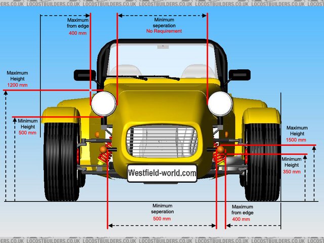

posted on 23/5/08 at 09:18 AM |
Front Indicators , Max in from edge of vehicle 400mm , Min seperation 500mm ,Max hight 1500mm , Min height 350mm .
Mike

posted on 23/5/08 at 01:23 PM |
This pic should help
![](/galpreviews/a747672-2Lighting-Front.jpg) ![Rescued attachment 2Lighting-Front.jpg](/gallery/a747672-2Lighting-Front.jpg) Rescued attachment 2Lighting-Front.jpg
finlay
posted on 28/5/08 at 09:14 AM |
that is the best drawing ive seen
cheers
