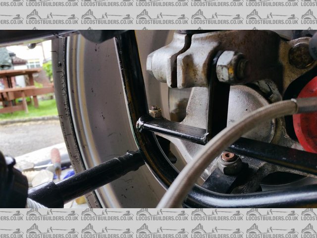

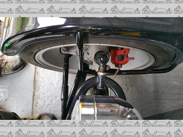

I haven't had any problems with the MK supplied ones.
I changed the flat strip for tubular fitting.
Just read your last post. Here are a couple of photos of the MK fixing brackets.
[Edited on 29-8-19 by 40inches]
andy188
posted on 29/8/19 at 11:34 AM Reply With Quote
Great, Thanks for the photos, yeh the brackets going to ball joint etc are thicker than mine,
Looks like ill beef them up a bit, spoke to some off the guys at work, ive had a back back, so we softened the ride up, could be its too soft, allowing more movement off the arch, (vibrating, over bumps). Busy weekend ahead.
