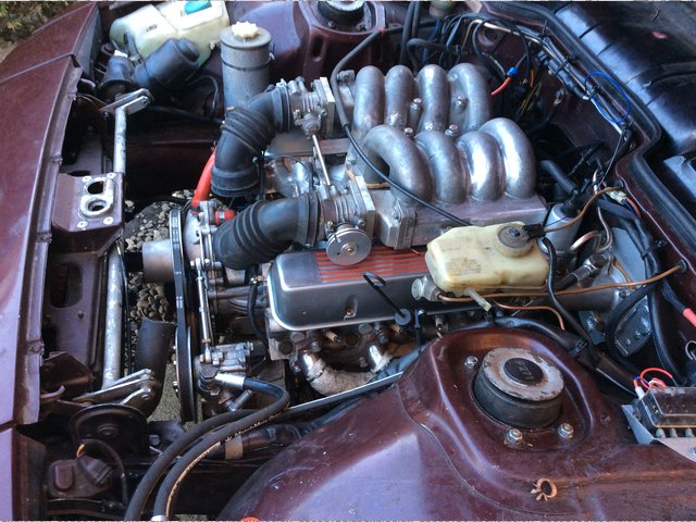

Hoping to get the cold start and idle sorted on this so I can get it over to you for tuning.
944 V8 done
944 V8 done
BaileyPerformance
posted on 6/2/18 at 05:19 PM Reply With Quote
944 V8 done
944 V8 done
Dont worry, we'll sort idle and cold start here.
We use 1.8/2.0 Zetec idle valves on RV8s, 2 wire, work great. Just need to make i little plate up to allow connection of pipes.
Cheers Dale

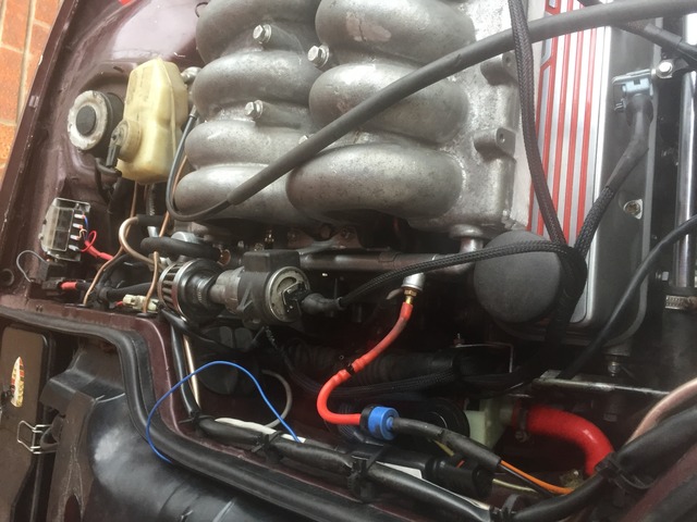

Cheers, Ive fitted a 2 wire bosch unit, feeding each plenum from the back, I just need to figure which settings to use, I think I ned closed loop, and then set the decay in pwm idle settings....
2 wire bosch
2 wire bosch
BaileyPerformance
posted on 7/2/18 at 10:03 AM Reply With Quote
2 wire bosch
2 wire bosch
I could never get the Bosch to work properly on PWM, i used a resistor and capacitor to form a charge/pump circuit to feed the Bosch with DC voltage in relation to PWN duty.
Your best bet is to bin the Bosch and fit a Zetec valve which works far better.
Cheers Dale
