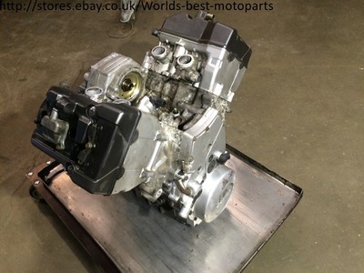

Also, here are a few "ramblings of a madman" having thought about this in the bath and had a few late night, beer infused google sessions, i came up with the following on a similar theme -
The difficulty (added complication) of the 2 x i4 configuration is that you either have to have them facing the same way and then the exhaust / inlets clash or have them facing opposite ways and then you need one engine to run an idler to get the correct rotation onto the driveshaft.
I looked at whether you could have two v2 / v4 engines side by side, each canted over opposite ways to make a sort of w4/8 but this makes it very wide.
Finally I stumbled across what I think may be a reasonable compromise -
The St1300 Honda Paneuropean has a more car like v4 engine:
1,261 cc 90-degree V-4, chain-driven DOHC
Power 117 hp (87 kW) @ 8,000 rpm
Torque 117 N·m (86 lb·ft) @ 6,500 rpm
This sits longitudinally, is shaft driven and interestingly the gearbox seems to sit in the sump under the gearbox. These are extremely tough engines which regularly are seen in the classified with 100k miles. They are expensive bikes to buy but as they get older and if/when they get dropped the large amount of fairing will drive economic right offs I think.
So, the idea is that you put two of these end to end to make a 2.5l v8 which will rev to 8k+ and push out around 250hp with a reasonable amount of torque (for a bike engine). Not startling and no screamer but may be better suited to car road use. Looking at the pictures below there are a couple of neat areas, the sump come off the bottom of the block and is nicely horizontal to the V and it seems to have a ready made mounting for a drive shaft down the centre of the V.
So, the sump can be relatively easily made/designed from a rectangular billet of aluminum on a 3 axis mill (probably, designing on the fly in my head) and a gearbox mounting plate added to the end, a sprocket can be attached to the crank shaft at the rear of each engine, a drive shaft installed through the two holes on the block with matching sprocket used to connect via chains to the crank shaft sprockets. Add a fly wheel and clutch and off you go. No lubrication of the drive shaft/chains needed (8k self lubricating bearing are available).
I am sure it is not that simple but on the face of it this looks like a relatively simple way of getting a small capacity (although maybe long), high revving v8 with reasonable power and torque. Compared to a 2.0l duratec pushing out 250hp this will be relatively lightly stressed and probably a similar price (assuming you run this with the stock electronics in a dual system) but have a great v8 sound. I would suggest this be mated with an s2000 box/diff or and audi transaxle.
Any thoughts/ideas welcome.
