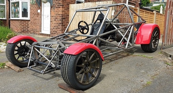

Hello all,
I'm new to the Locost Builders Forum. I am scratch building a Midlana with ST170 lump and six speed box.
I'm no stranger to a bit of metal fabrication so I feel I have made decent progress in the last 12 months. At this point I'd just like to show pictures of my build. Hope you like it...

Big wasa... I'm so glad you are interested because I need your help. The next stage in the build is getting the engine running. I wish to use the stock OEM ecu and wiring harness. Problem is, I'm a total noob when it comes to electrics. I have seen your thread on "stripping back" the OEM harness to only the minimum to get the engine running, this is path I want to take.

Having got that far is no small feat. There is an immense amount of work getting a roller. I estimated 10x that of a Locost.

Thanks It has been allot of grinding and TIG welding. My neighbours are now fully accustomed to the industrial noises coming from my garage
