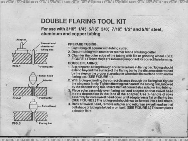

Flaring instructions
The 5/8" hole is the massive one at the end Joel, the grips are offset with their size to the right of them. When you tighten up the wingnuts do
the one nearest first. I've scanned the destructions in so you can follow them yourself. Happy flaring.

oops, i meant the 5/32 hole anyway! maybe you're right, i'll have a check to see that i read it right!
i read up from google about male and female flairs, so thats a good start. Did a couple of practice ones too, in the tight hole, they came out
reasonable for first attempt. Hardest bit seems to be getting the shards out of the middle of the tube, but with a bit of effort they come out.
thanks for scanning that pete, that sorts a few more loose ends!!!

pete had it right, i was in the right hole all along but the numbers are off center! and it was 5/8 the other one!
had some alright results out of it now, so i think im on top of things at last! til it comes to bleeding it... got a mate coming to do that!

You did say 5/32" in the first post, I was just quoting that the 5/8" hole is leftmost and the 3/16" was the one next to it. Glad
you are getting the hang of it. I must have done literally hundreds with mine over the years for myself and lots of others without any problems. Keep
practising and if you can, use a tube cutter like plumbers with the reamer on the back. Only about £5 and worth it to simplify things.
