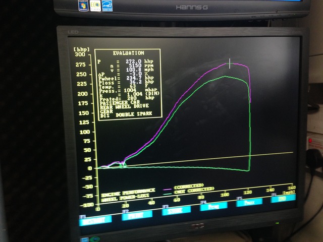

Now that the cars already to go, Dale started tuning, mainly adjusting graphs and figures manually before even starting the car.
The car performed amazingly, I was having nightmares of it blowing up, or not making it all day. Overheating etc. But nothing, apart from a minor oil leak from the Turbo Return pipe (bit of smoke in the videos)
Dale swapped out the spark plugs to ones he recommends as he noticed it wasn't sparking strongly enough. The majority of the tuning was done and then it was time to turn the boost up. Dale did loads of tests to see what boost it would safely run, then we did some runs and tweaked it so it boosted 1 bar.
As soon as the torque started climbing the wheels started spinning on the rollers, even spraying spray glue on the rollers to keep traction, but nothing worked. I had to remove the diffuser so we could strap it down tighter, which eventually worked. But started melting tyres !!!
Once peak power was set, Dale set about fine tuning the curve to reduce any dips and then tuned the cruising stages etc.
Graph
Graph

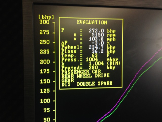

BHP
BHP

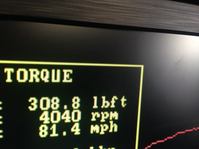

Torque
Torque
Final result was 272bhp and 307ftlb of torque, the things a monster! Boosting hard from 1800rpm but very progressively all through the rev range.
