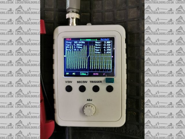

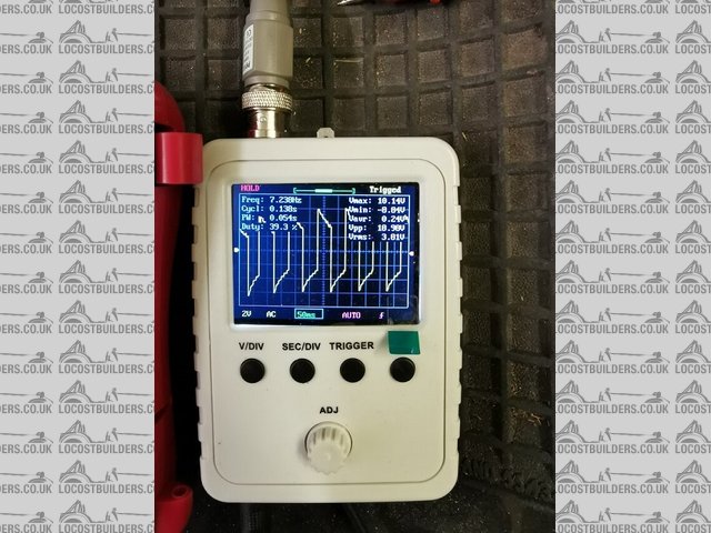

3) I’ve put a scope on the VR and PIP signals during dry cranking (plugs out, spark produced). Could someone advise if the traces shown below seem sensible? I was expecting PIP to be 0V to +12V square wave, but it seems to be -10V to +10V and not quite square... (see VR and PIP traces below).
VR:
VR_signal
VR_signal
PIP:
PIP_signal
PIP_signal
Does anyone have any real examples of VR/PIP signals in a similar setup?
