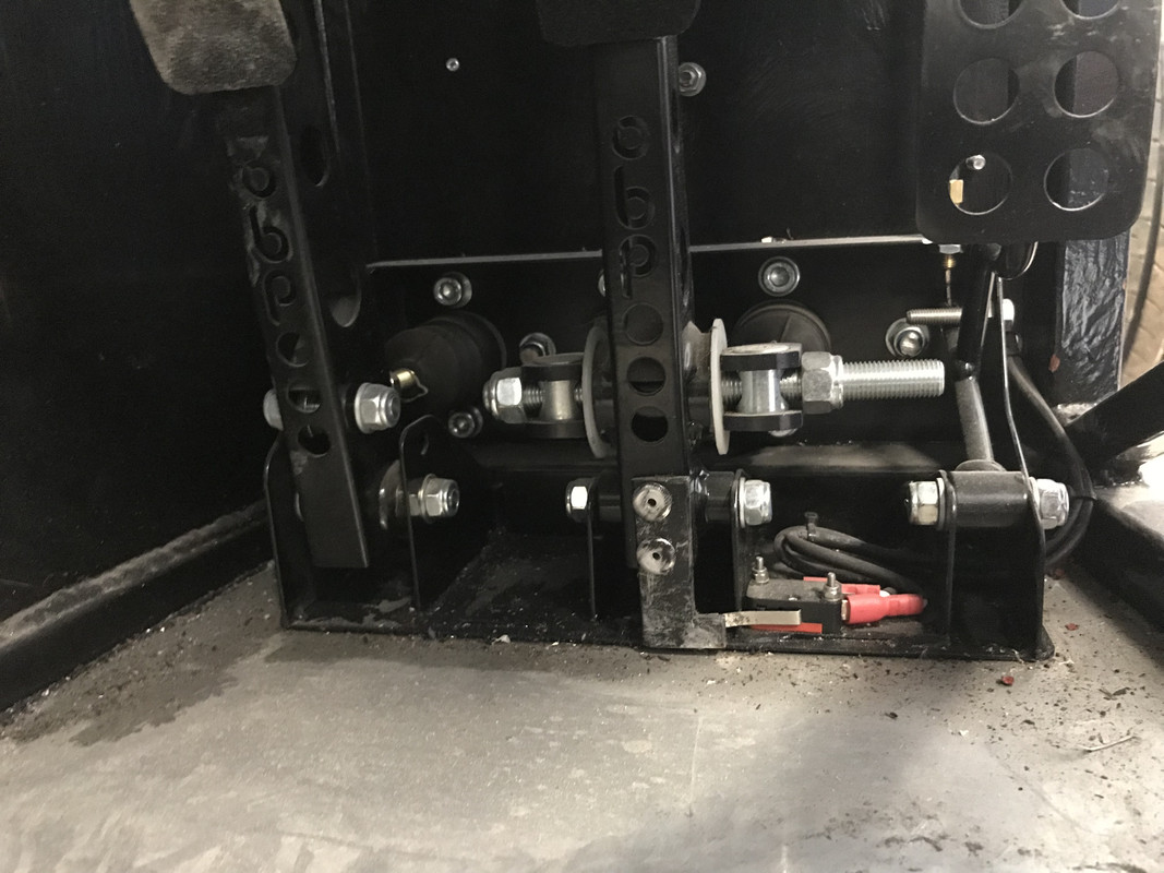

So I'm just looking at the throttle pedal at the moment, and basically because it doesn't return via the throttle spring alone.
Picture courtesy of Craigdiver
I was thinking some kind of torsion spring is what's required, but there isn't much room around the pivot. Any pictures of your solution please MikeR?

Ah, my obp pedal box is older than that and top mounted throttle. Sorry.

That's an unusual throttle pedal design
So when you press the pedal it pulls the throttle cable down - so you could put a compression spring under the back of the pedal or....
you could put a torsion spring, like the picture below, around the pivot bolt

Yes that is the type of thing I was looking at. The main problem is the lack of space either side of the pedal. OBP do a throttle spring for one of there other pedal boxes but there just isn't the room on this one.

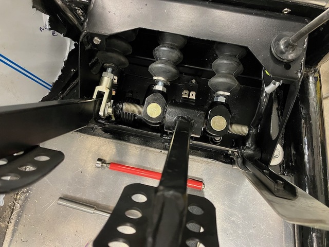

Whilst I don't have the same OBP pedal box, I'm using a similar format generic pedal box in my RH build. On that there is provision for an extension spring to be mounted in parallel with the throttle cable, so could you do something similar on yours? I did find an Austin Metro single torsion spring that looked promising for adaptation onto my pedal but didn't bother in the end. There is also a Land Rover Defender throttle spring available on eBay as another alternative.
pedal box 1
pedal box 1
For the Brake and Clutch pedals I modified the assembly to use a Rover Mini pedal return spring so they return to the stop position provided by the pedal box housing. It's not that important in operation of the car, but during build with no hydraulics in place it made it much easier to simulate the pedal function.
