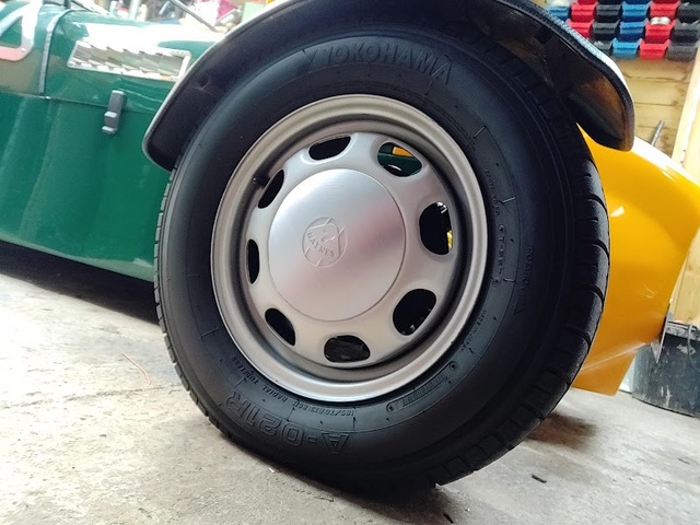

Stot
posted on 1/9/23 at 03:33 PM |
Among other things, I made some hub caps.
Didnt last long.
Stot
