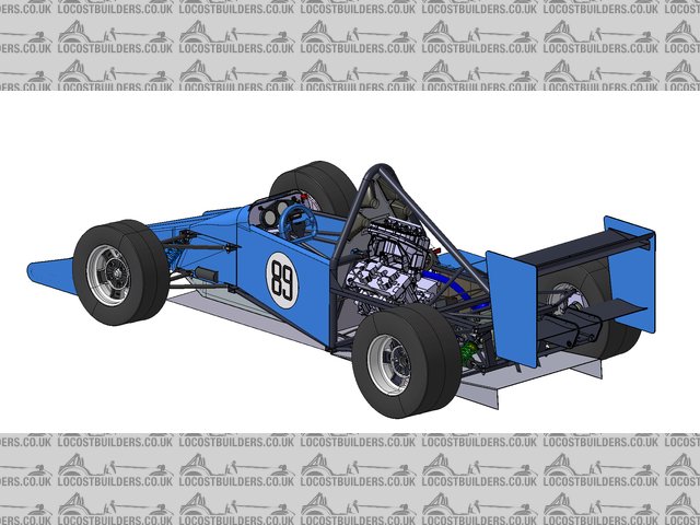

With Body:
![](/galpreviews/SSL August ISO 1.jpg) ![Description](/gallery/SSL August ISO 1.jpg) Description

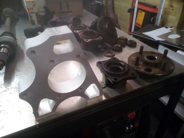

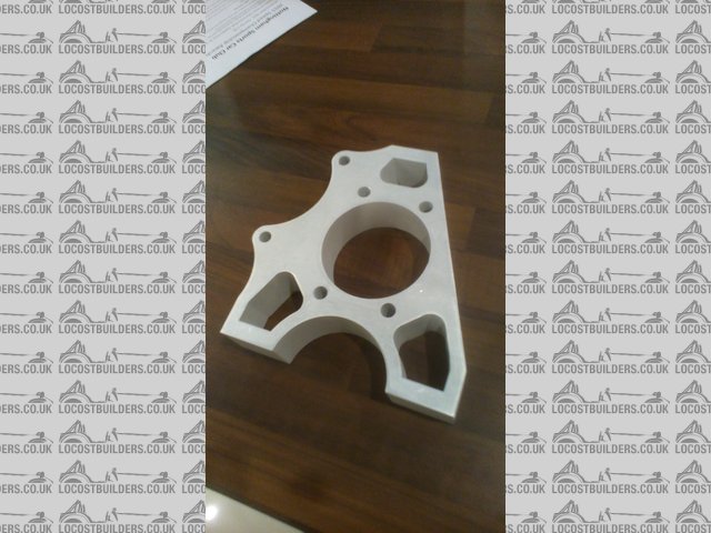

Starting to get some of the fabricated parts back now, first is the water jet cut Rear Uprights and Rear Suspension Rockers:
Rockers:
![](/galpreviews/Rocker Plates.jpg) ![Description](/gallery/Rocker Plates.jpg) Description
Rear Uprights to take Sierra Bearing carrier and Wilwood Dynapro caliper:
![](/galpreviews/Water Jet Cut Upright 1.jpeg) ![Description](/gallery/Water Jet Cut Upright 1.jpeg) Description
![](/galpreviews/Water Jet Cut Upright 2.jpg) ![Description](/gallery/Water Jet Cut Upright 2.jpg) Description
![](/galpreviews/Water Jet Cut Upright 4.jpg) ![Description](/gallery/Water Jet Cut Upright 4.jpg) Description
The caliper mount lugs need to be milled back to get the correct caliper position but everything fits together perfectly.

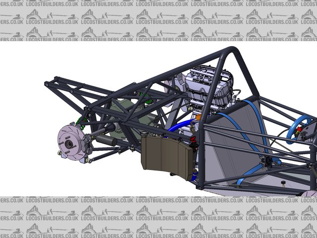

Rear Suspension and driveline now fully sorted in the virtual world as well:

I've not updated this thread in a while, not because the project is stalled but mainly there has been alot of background activity going on. Part
being manufactured and orders placed.
I have also had to complete the last major design task which was to fit the engine to the completed chassis, make the engine mounts and then reveres
engineer them into CAD and drawings.
I have also applied to legally register the designs so that I shouldnt be ripped off once I start selling them and have also been beavering away on
making it abit more pleaseing on the eye, especially with some more svelt side bodywork.
I have also managed to fit in a little homage to my favourite race car the Tyrrell P34 if anyone can spot it.
![](/galpreviews/SSL Full CAD 30-11-15.jpg) ![Description](/gallery/SSL Full CAD 30-11-15.jpg) Description
