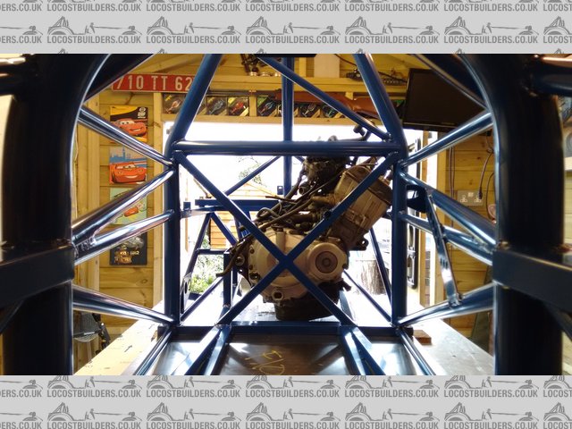

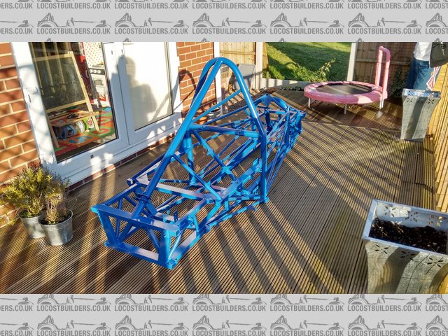

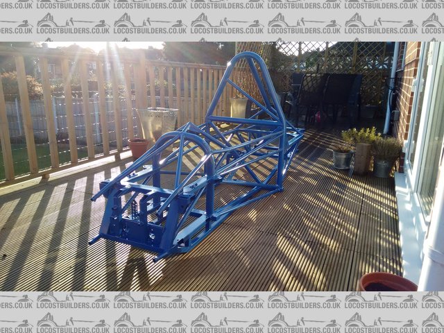

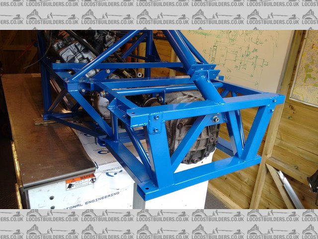

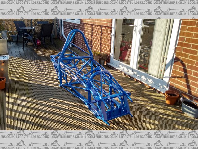

Chassis collected from the powder coaters today, its looks amazing in bright blue:
![](/galpreviews/IMG_20160407_182956006_HDR.jpg) ![Description](/gallery/IMG_20160407_182956006_HDR.jpg) Description
![](/galpreviews/IMG_20160407_183009677_HDR.jpg) ![Description](/gallery/IMG_20160407_183009677_HDR.jpg) Description
![](/galpreviews/IMG_20160407_183045763.jpg) ![Description](/gallery/IMG_20160407_183045763.jpg) Description
Collecting the aluminium for the panels this week and then its on with the final push to assemble it.

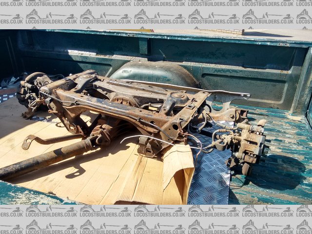

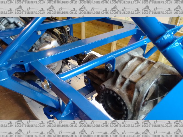

Some good progress on the sales and design front recently. I have just picked up a complete MX5 rear end so that I can do the much-requested MX5

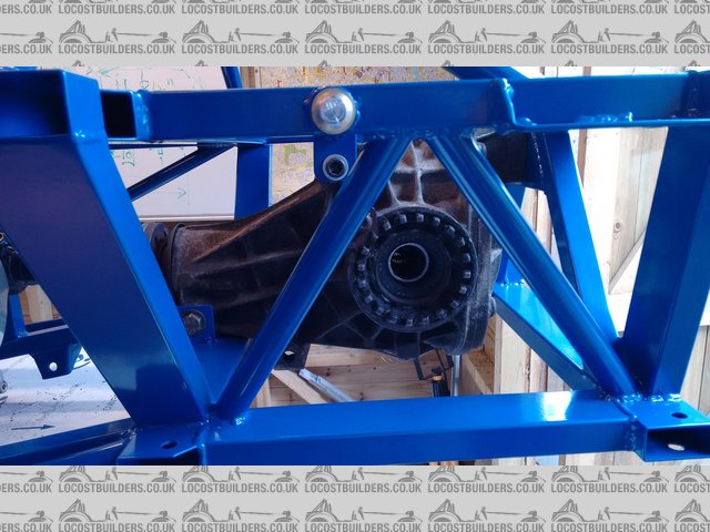

Driveline option:
![](/galpreviews/IMG_20160419_143151113_HDR.jpg) ![Description](/gallery/IMG_20160419_143151113_HDR.jpg) Description

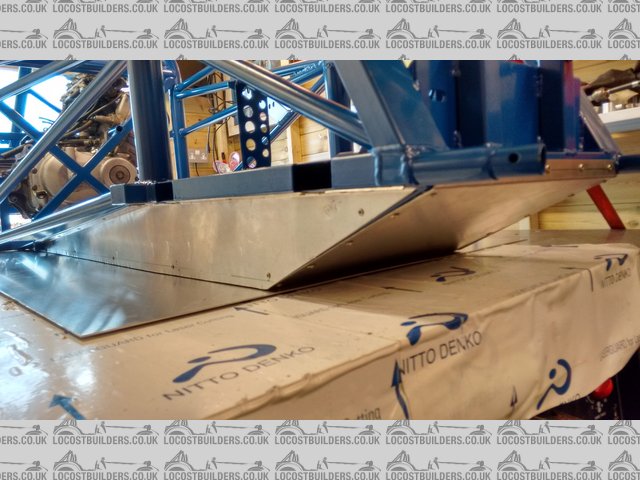

Doctor Derek Doctors
posted on 25/4/16 at 07:00 PM |

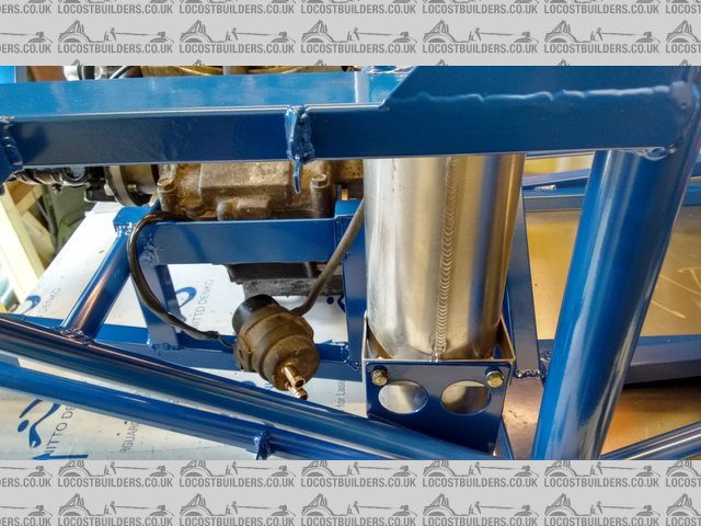

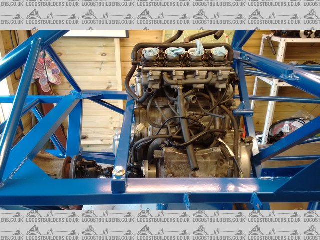

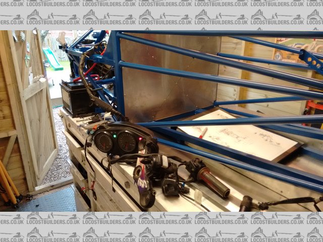

Loads of Progress

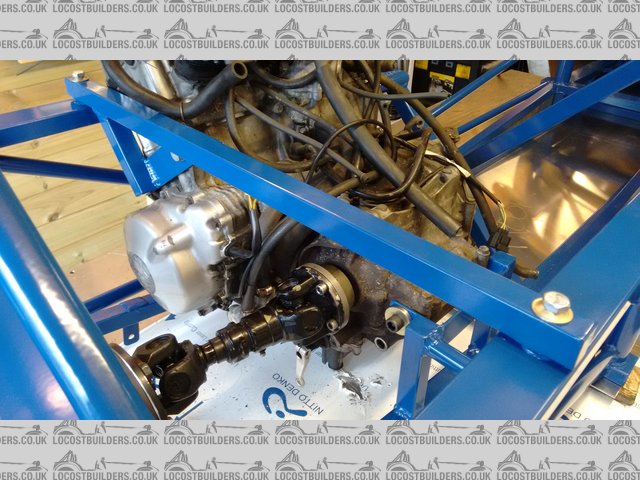

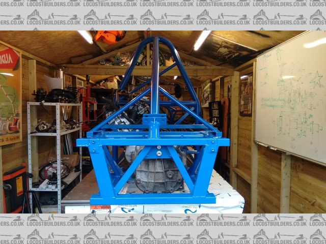

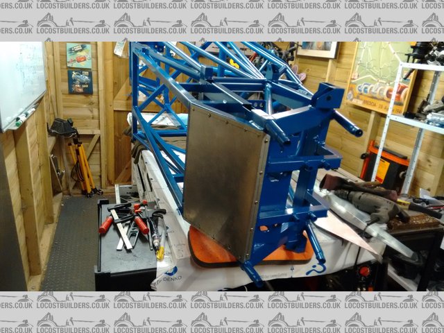

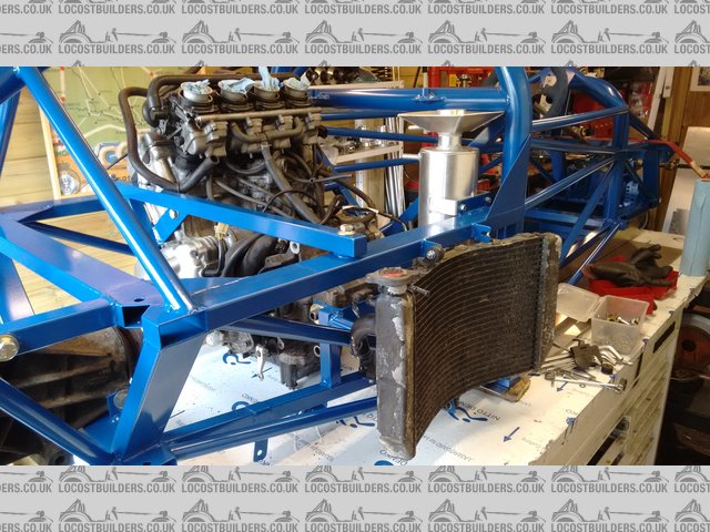

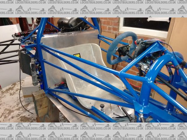

I have been pushing on with final assembly this weekend. Thanks to my mates for helping lift the engine in.
The chassis is now panelled, engine & drivetrain are in and the steering and loads of other bits are being built up.
![](/galpreviews/IMG_20160424_182838351.jpg) ![Description](/gallery/IMG_20160424_182838351.jpg) Description
![](/galpreviews/IMG_20160424_182857386.jpg) ![Description](/gallery/IMG_20160424_182857386.jpg) Description
![](/galpreviews/IMG_20160424_182908498.jpg) ![Description](/gallery/IMG_20160424_182908498.jpg) Description
![](/galpreviews/IMG_20160424_182921863.jpg) ![Description](/gallery/IMG_20160424_182921863.jpg) Description
(yes I know the propshaft need re-phasing)

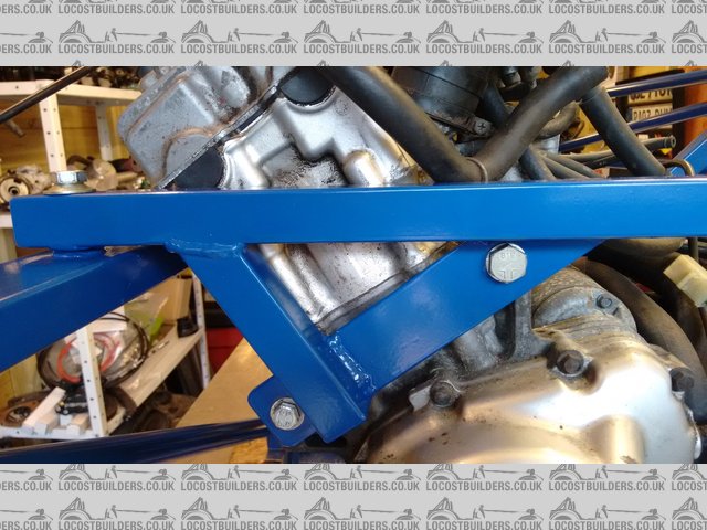

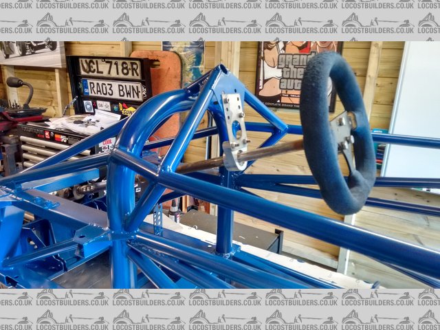

Steering drop plate needs a stiffening rib adding:
![](/galpreviews/IMG_20160425_131729011_HDR.jpg) ![Description](/gallery/IMG_20160425_131729011_HDR.jpg) Description

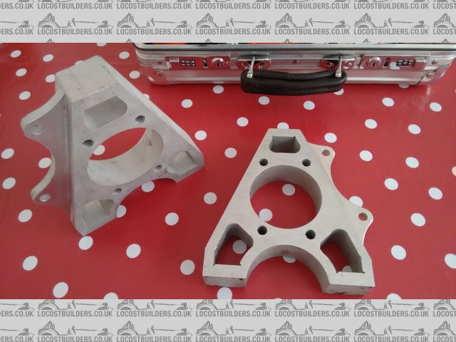

Rear uprights machined (just need holes drilling for suspension pick-ups:
![](/galpreviews/IMG_20160429_185209549.jpg) ![Description](/gallery/IMG_20160429_185209549.jpg) Description

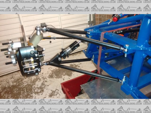

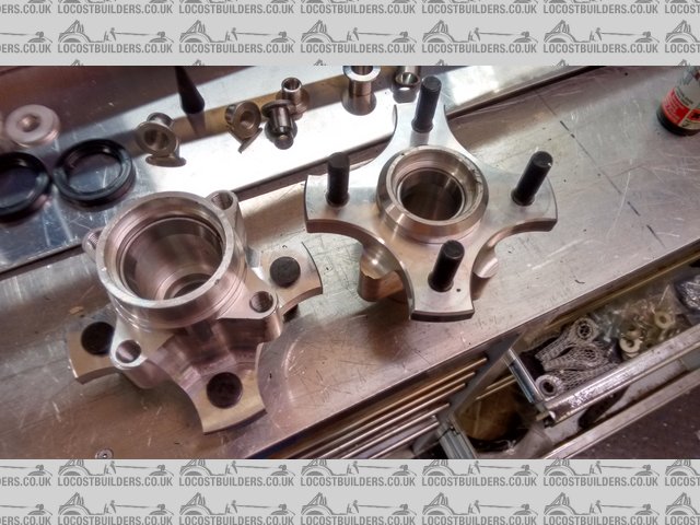

Front Hubs:
![](/galpreviews/IMG_20160501_140542116_HDR.jpg) ![Description](/gallery/IMG_20160501_140542116_HDR.jpg) Description

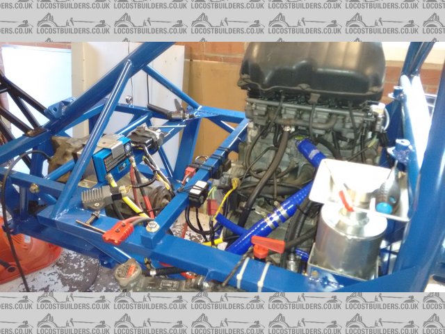

I piggybacked the original bike woring loom onto the car and started the engine at the weekend. I have since chopped the loom down to remove the
unnecessary bits and started it up again to check I didn't knacker anything and it all works fine:
![](/galpreviews/IMG_20160501_172209479.jpg) ![Description](/gallery/IMG_20160501_172209479.jpg) Description

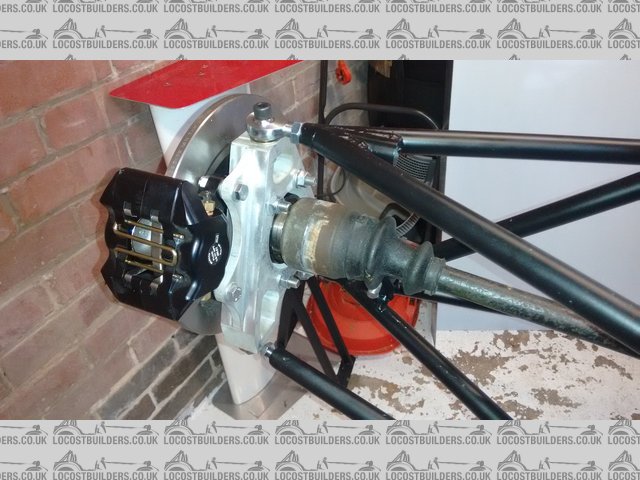

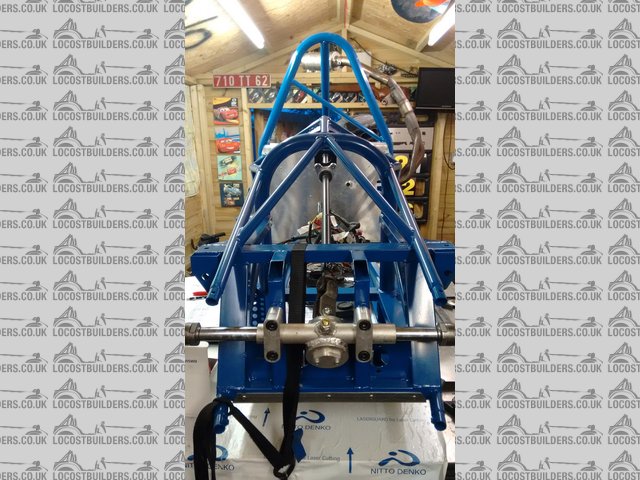

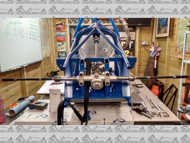

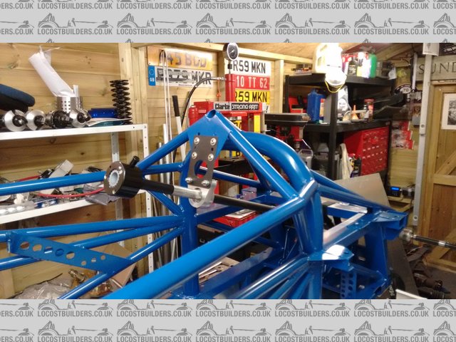

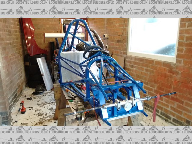

Steering in and looking good:
![](/galpreviews/IMG_20160511_205709607.jpg) ![Description](/gallery/IMG_20160511_205709607.jpg) Description
![](/galpreviews/IMG_20160511_205722039_HDR.jpg) ![Description](/gallery/IMG_20160511_205722039_HDR.jpg) Description
![](/galpreviews/IMG_20160511_205735154.jpg) ![Description](/gallery/IMG_20160511_205735154.jpg) Description

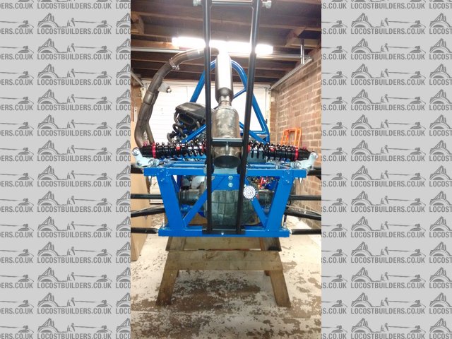

The drivetrain is complete, tested and run up. The suspension is all fitted but just waiting on Coilovers and a couple of bolts, the controls are all
fitted and the brakes are nearly done.

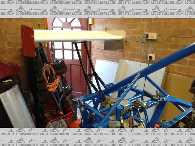

Rear Wing and Post Fitted:
![](/galpreviews/IMG_20160528_201040993.jpg) ![Description](/gallery/IMG_20160528_201040993.jpg) Description

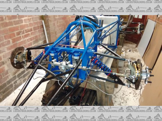

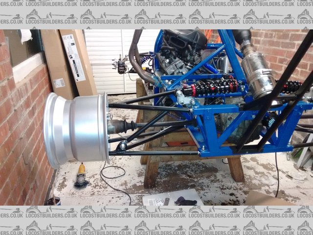

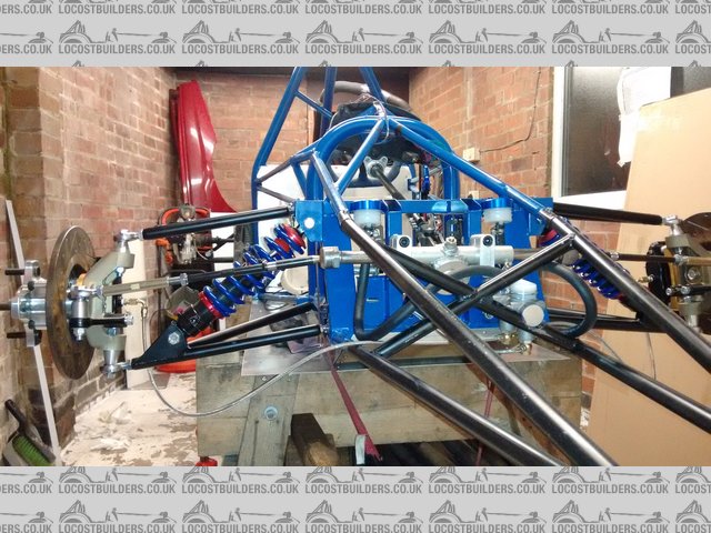

Front Suspension Fitted (note that the dampers are just dummies and are 2" too short)
![](/galpreviews/IMG_20160530_203022720.jpg) ![Description](/gallery/IMG_20160530_203022720.jpg) Description
![](/galpreviews/IMG_20160530_203039328 - 1.jpg) ![Description](/gallery/IMG_20160530_203039328 - 1.jpg) Description
![](/galpreviews/IMG_20160530_203203227.jpg) ![Description](/gallery/IMG_20160530_203203227.jpg) Description

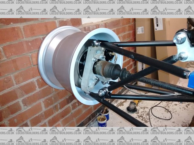

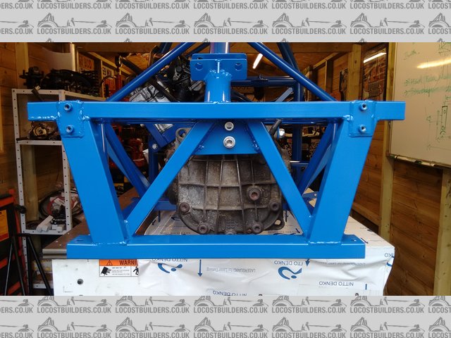

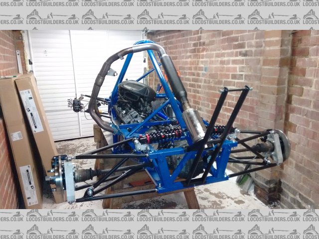

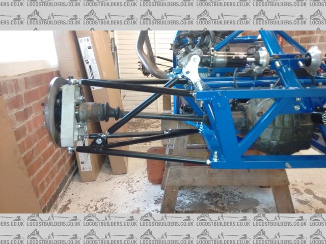

posted on 13/6/16 at 03:33 PM |

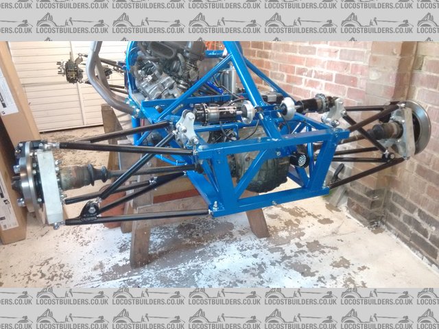

Driveline and Rear End
The rear end is now complete (well aside from commissioning), all of the suspension and driveline are built up. The exhaust is done (in true
'locost' style it cost £27). I ran it up through the gear yesterday and all works perfectly.
To complete the front end I now just have to fit the front struts (when the springs arrive) and finish one brakeline when the fitting arrives.
Anyway; Exhaust, its not too everyones taste but it is proper 'Locost', the manifold and rear can from the donor bike, with e universal
silencer and a 90° bend.
![](/galpreviews/IMG_20160610_225837352.jpg) ![Description](/gallery/IMG_20160610_225837352.jpg) Description
Rear suspension is now also finished:
![](/galpreviews/IMG_20160610_225847536.jpg) ![Description](/gallery/IMG_20160610_225847536.jpg) Description

![](/galpreviews/IMG_20160614_221947297.jpg) ![Description](/gallery/IMG_20160614_221947297.jpg) Description
![](/galpreviews/IMG_20160614_221956735.jpg) ![Description](/gallery/IMG_20160614_221956735.jpg) Description
Also instead of using the standard "Foam Bag" seat I have just used a low price OMP Kart seat, it fits perfectly and is rather
comfortable:
![](/galpreviews/IMG_20160614_222004090.jpg) ![Description](/gallery/IMG_20160614_222004090.jpg) Description
Just the harness to bolt in and then its bodywork.
Designer and Supplier of the T89 Designs - Single Seater Locost. Build you own Single Seater Racecar for ~£5k.

Wide Wheels
Tried the 9x13 Revolution wheels on last night, everything clears and they look wiiidddddeeeee!
![](/galpreviews/IMG_20160616_222436521.jpg) ![Description](/gallery/IMG_20160616_222436521.jpg) Description
![](/galpreviews/IMG_20160616_222447027.jpg) ![Description](/gallery/IMG_20160616_222447027.jpg) Description

phelpsa
posted on 17/6/16 at 10:20 AM |
What size slicks are going on there? 8/22?
posted on 17/6/16 at 11:07 AM |
230/570 Radials, seem to be a common size without requiring mega expensive wheels. The Revolutions were £114 each for the rear.
