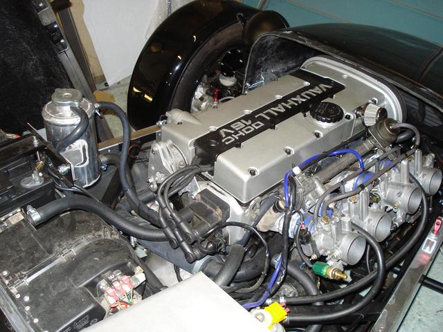

My Velocity is fitted with an XE and it is a dream to drive. It's not just that it is fast but it is also the power delivery and noise. I use a standard type 9 and a set of throttle bodies but I would think that a simple carb job would still be very good.
I have not driven a 7 with a Zetec in but I have driven the original Fords they came from and they were hardly good cars to drive. Go for the XE, they're Great.
Where are you? Are you going to any of the shows this Summer? I'd be happy to take you out in mine for a spin. Rescued attachment DSC02130a.JPG
