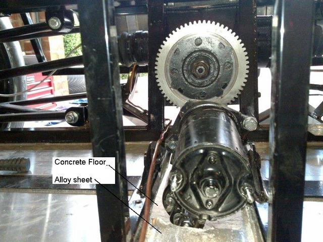

Jst a few pics of what the reverse box mk provided me looks like when fitted...
mounts were welded on by MK

Thanks for posting those. Have been trying to figure out how to do mine and that has really helped finally seeing one installed. There's not a lot of room and that shows me it can be done. How close to the tunnel sides is the ring gear when you put the panels on?

How close to the starter does the prop get? Must be pretty tight? I see the floor is cut away to allow for the starter solenoid, are you going to cover it?

Floor doesn't look cut away to me?

posted on 10/4/09 at 11:55 PM Reply With Quote
Bit easier to see in this photo.
I only noticed because I was struggling to see on mine how I could get the starter to fit above floor level and assumed I would have to cut away a section of the floor and make a bubble cover.

Oh aye yes. My drunken eyes deceived me.

Does anyone think it is possible to use a smaller starter motor so that you dont have to cut away at the floor?
Hellfire
posted on 11/4/09 at 09:50 AM Reply With Quote
It's mentioned earlier that MK now use a smaller/cheaper starter, so maybe no need to cut away the floor? Maybe worth giving them a call

thats 1 of the problems iv noticed, the sprocket sticks out by 1-2mm on each side of the tunnel. so somehow i will have to space the panels off the tunnel, something i will look into when i come to it.
as for covering the solanoid with something i dont think this will be necessary as the sump drops closer to the floor.. unless ofcorse mr iva says that it must be covered...

Gear reduction starter tend to have a seperate "flange" that you can rotate so that you can position the solenoid where you want - maybe this is the way forward?
