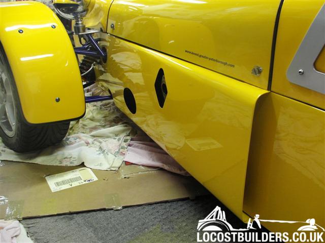

And to get the hot air out again...........
Vent side 2
Vent side 2
Vent side 1
Vent side 1
Not my car but another member here.
I made 'em though
Time is an illusion. Lunchtime doubly so.................Douglas Adams.
