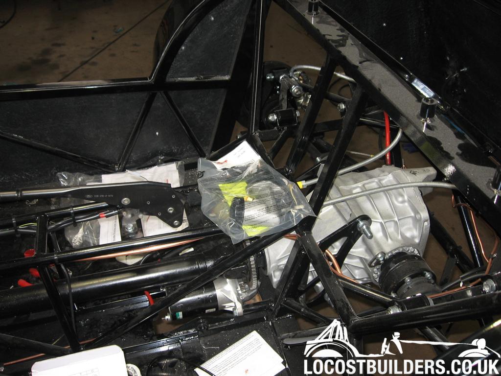

This is the MK setup (picture taken during my visit)
I think the power of a bike engine is a bit low to reverse your car. I should choose a car starter motor (preferably a diesel one,which have higher power than petrol).
As you see on the photo, the starter gear is only engaged when you power it.
I think it is possible to control the speed, but then you would need expensive power-electronics.
If we would go for a group buy of the ring gear as in the MK setup, I also would be interested.

I have the MK set up. Speed control is achieved via the brake pedal! I'd consider it as an emergency measure only and to keep IVA man happy. I don't think a bike starter would be up to the job, definitely not as a permanent fixture anyway.
And as above it only engages when you press the go backwards button.

With a car starter the solenoid makes the gear only engage when the motor is powered.

I know I've said it before, but this looks like a great daily-driver road-going solution. I do have a lightweight version on my car (AB unit), with a motorcycle starter (satisfies the MSA man when my fellow competitors start objecting).
I just love the amount of space that MK give you underneath the diff flange, tailor made.
