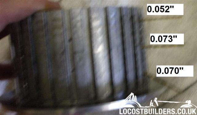

Also a few folk have mentioned the clutches on A1’s are fragile and lack lubrication and I should change it for a later models assembly, which bits do
you change and why?
Many thanks in advance

as for the clutch just fit a new set of genuine plates and some ape springs check your steels are ok if you like you can mod the basket centre drum
with small holes for oil to pass but i would try new bits first see how you go
[Edited on 19/11/09 by imp paul]
