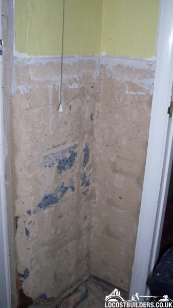

Just started knocking tiles of our lovely 1950's bathroom and have now got this -
The question is -
Do I knock ALL(!) the plaster off down to the blocks, including the upper painted part and get it completely plastered.
Can a plasterer build up the lower section then skim the (suitably keyed) upper section as well as the lower.
The Photo shows just one section, the whole bathroom will need doing...
Any advice gratefully received!!
Best Regards
Martin.

I guess this is the pic?
If the remaining plaster is solid I would personally leave it and make good, but then again I'm not a plasterer!

if its anything liek when my parents did theirs, take the lof off, even the ok looking stuff fell off with a few prods, if you going to pay to have it
done might as well gev everything done for only a little bit more.

If the plaster that is left on is solid then no need to take it off, but otherwise take it all off. A good plasterer can build the lower part up and
skim over the rest.

If the plaster is sound, i.e. when you tap it with your knuckles if it makes the same dull sound all over then it's probably ok. The plasterer
will just PVA it then skim it once the PVA goes tacky.

The section you can see will be painted but the room will be mostly tiles.
The top 'skim' layer does come off fairly easily, underneath it is well attached to the block work so as suggested I'll start with
removing the top layer and take it from there.

Over that small an area there isn't going to be a huge cost difference between a skim and a full rework, I would suggest to take it all off and
start from scratch!

I'd plasterboard the bottom and then skim the lot.

If its not damp then id use pva then build up the lower wall with bonding coat(browning) just so that when you plaster it the thickness difference
isn't all over the place ,check for any other loose bits ,if it sounds hollow then knock it off . if you do use the bonding coat then wait till
its totally dry before you skim it other wise it will take ages to dry out ,the plaster has to be pink before you can paint on it.

I install bathrooms for a living, if the plaster is not solid,knock it off down to bricks and use plasterboard adhesive to stick plasterbords on to
brickwork. Then skim the lot after coating with PVA. It will take less time to dry out this time of year.

if its solid leave it on, patch it up with bonding and then patch the skimming into the top section.
if you want it all skimming put thistle bond-it on to the top section of wall(saves having to key the wall) then skim the lot after bonding the bottom
section.
don't seal anything with pva before tiling, use a proper primer.

thats the best way if its all or mostly loose. not worth it if you have only got a few bad areas.
no need to skim plasterboard either if its being tiled, infact it can support much heavier tiles than when its skimmed
