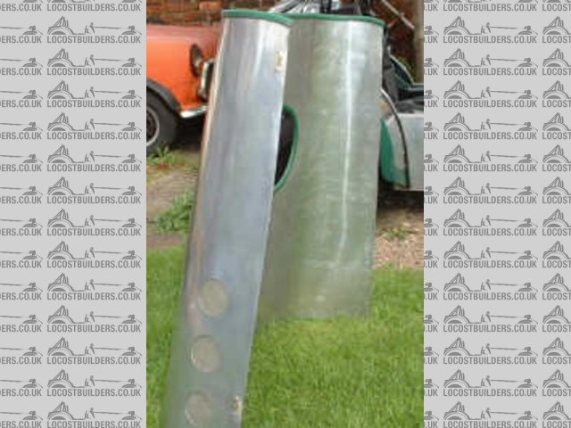

I used the ratchet strap to do mine before I put the engine in. Rescued attachment bonnetside.JPG

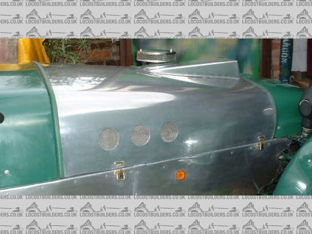

posted on 14/5/04 at 05:18 PM Reply With Quote
I trimmed the ends with green beading.
I didn't bother with returns and the bonnet pulls flush with the case clips. I put R clips through the front ones to stop them releasing. Rescued attachment bonnetupright.JPG
