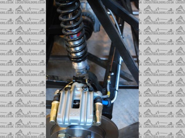

AdamR
posted on 28/3/10 at 12:51 PM Reply With Quote
I'm not using a Sierra lever either. It doesn't matter too much what lever you use as you have to rework that bit anyway. The benefit of using the Sierra cable is that the outers are just the right length and fit perfectly in the two holes that most chassis' have cut in the rear bulkhead.
Here's my set-up:
I've still got a bit of work to do joining the cables to my fabricated balance bar thingy, as you can see.
[Edited on 28/3/10 by AdamR]

posted on 30/3/10 at 05:43 PM Reply With Quote
Adam, the vw calipers that I have attach the cable through an upside down 'U' type arrangement - the cable just had a nipple on the end. Have you just hooked the loop on the end on the sierra cable onto the upside down 'U' - can't quite see on the photo? Also, do you have any idea how long the sierra cables were?
Miks - I believe that there is an autojumble at newark soon - you might find some cables there - that's my plan anyway!
Cheers all, JC
AdamR
posted on 30/3/10 at 06:26 PM Reply With Quote
Cheers all, JC
Yep, cable ends hook nicely over the, um, hook/lever thingy as you describe. This works so naturally that it hadn't even occurred to me that the Golf cable ends might connect in a different way.
I don't have the length of the Sierra cable to hand, but the outers are the perfect length for my +4 chassis with de-dion. The inner cable is far too long, but that's fine as you have to chop the cable to poke it through the bulkhead anyway.
HTH
