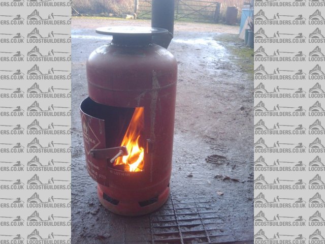

made one from a 19K bottle
works a treat
wood burner
wood burner

Tips: have a baffle about 2/3 of the width of the bottle, have the baffle about 5cm above the top of the door, line the inside vertical walls with firebricks, have adjustable air intake on the door, don't bother with an ash tray: just allow a bed of ash to fill the bottom and scrape/scoop off the excess when needed. Don't bother with a grate, wood burns well on a bed of ash and likes air from above, not below. Make a door by using another gas bottle of the same size (you can get 3 doors per cylinder) and make it bigger than the door hole, then it'll need persuading with hammers and standing on it to match the curve of the bottle.
Weld 6mm rod round the outside and grind it back leaving a smooth edge, then weld another 6mm rod about 5mm in from the outer rod, then tap in some fire rope. The inner rod only needs to be tacked in place as it's not on show.
I'm putting a 6mm hotplate on mine for the kettle. Pub CO2 bottles sliced into hoops give you the perfect collar to accept 5 or 6" (can't remember which) flue.
If you want to go a bit more advanced you can make the baffle into a secondary air intake which heats the air before it enters the combustion chamber. If you get it right you'll see small blue flames as otherwise unburned wood particles ignite.

Yep, dead easy. Only thing I would do next time is make the main door much bigger and have the air inlets at the top with just a little door at the bottom to rake the ashes out.
Then the only problem for me is I don't have room in the garage for it!

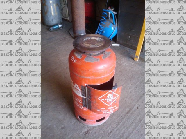

here is one I made. MGF rear disc for hot plate. Plant to weld stip inside to make a better door seal, then add a slide vent blow the door.
stove
stove
stove
stove
the hot plate wont be that efficient but thought it looked good and it was all made with stuff we had lying around
