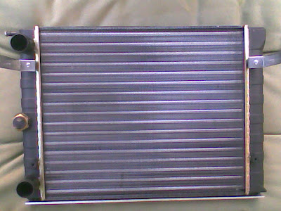

BenB
posted on 18/2/11 at 03:09 PM Reply With Quote
Most people just use the small mounting holes as shown here
I used some very short coach bolts which screwed into them nicely. I used these to clamp onto short straps which I rivetted into the chassis at the other end. Be careful if you go down this path though because the holes in the mounting holes are blind and very short and you use too long a screw and too much gusto with the spanner you'll go through into the radiator end pieces...
