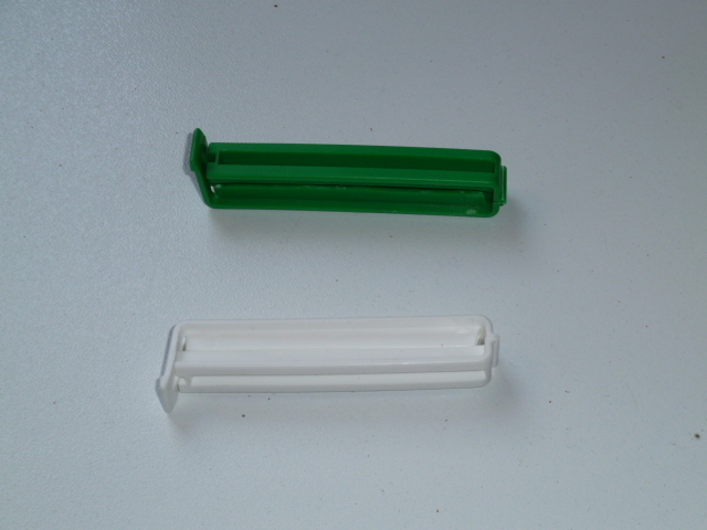

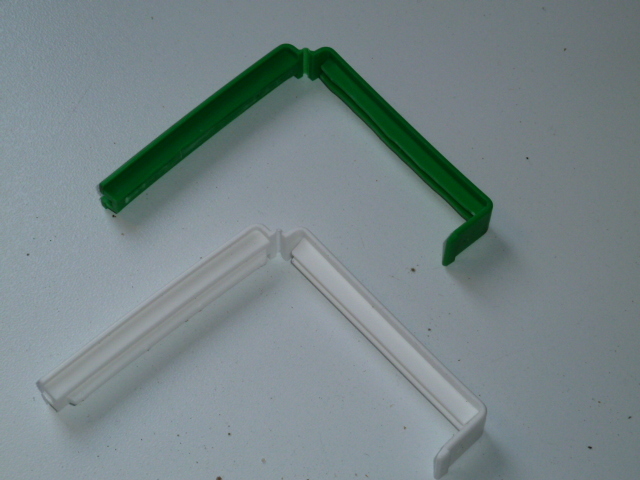

Solved for £1.69p!
I think I've found a solution, courtesy of Lakeland kitchen shops!
I bought a packet of these food bag sealing clips for £1.69p (they come in all sizes, and I found a pack of 5 at 75mm width).
Then trimmed off the single rib on one side, and reduced the double ribs on the other (look at the green one in the photo).
I picked one yellow and 1 red - I may go mad and buy another pack to get 2 the same colour!
Seems to work well, but only time will tell if they will get 'tired' or break. They'll do for now though...
