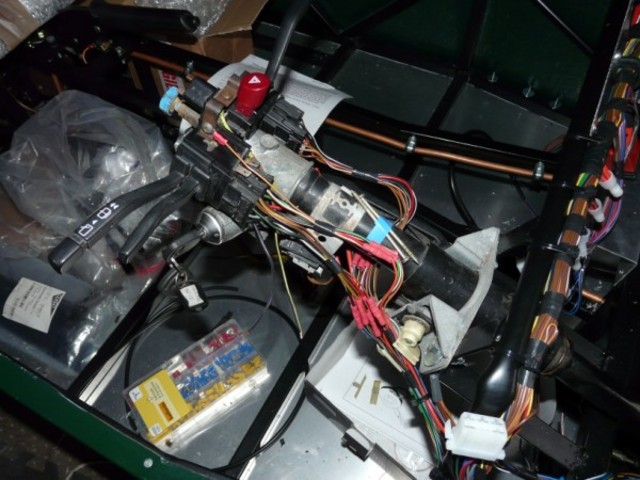

Hi all,
I'm thinking of removing the upper cast part of the column where all the switches and ignition barrel attach - mainly because I want to put a
paddleshift on the column.
Is there any way of taking all of the cast bits off without damaging them? Or is it a case of cutting it off?
From this:
![](/galpreviews/Steering Column Wiring.jpg) ![Grafting loom to stering colum](/gallery/Steering Column Wiring.jpg) Grafting loom to stering colum
(big-vee-twin's pic)
To this:
(Davegtst's pic)
I think I read somewhere there is a grub screw holding the cast part on but I can't seem to find it! Saying that I'll go back into the
garage and see it straight away
James
