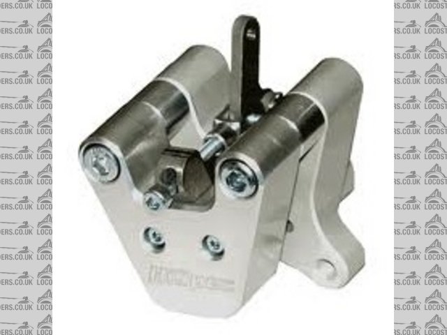

I've decided to go with a spot-caliper on the single-rear wheel of the reverse-trike and fancy controlling it with a linear actuator as I'm struggling for room for a handbrake-lever.
I've found a couple of actuators that can pull and hold a force of 10kg... anyone have any idea if that would be enough to pull-on a spot-caliper and hold a 275kg vehicle?

[9.The ‘parking’ braking system must be capable of being operated using a control which is independent of the service brake, and once applied capable of being maintained in the ‘on’ position solely by mechanical means.]
IVA manual, Brakes, 09A, para 9.

I think you'd be looking at 5-10 times that force at least. There are loads of modern cars with electric park brakes, I'm sure one would be suitable.
Because it must be held on by mechanical means, you'll need something that operates using a screw type actuator so it stays where it is when powered off.

It's just a single Hispec spot-caliper that I'll be using. I'm pretty sure that the mechanism-arm would explode if subjected to 100kg of force.

My thinking is that you need to be able to lock the brake on (as don't want to leave it powered). This managed on commercial systems with a screw thread type mechanism.
I think you can get enough force, just by using more leverage, as you don't need to move the pads very far at all.

on my MNR i used VW passat rearcaliper, they have a electric handbrake thats iva proof.
Very easy to wire and they keep activated also when power fails.
