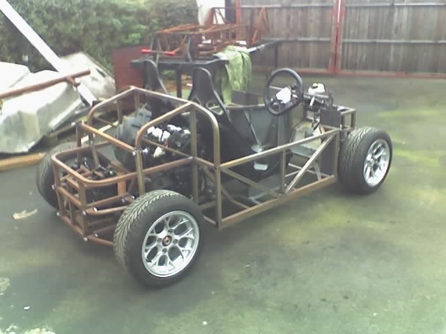

posted on 24/7/12 at 09:59 AM Reply With Quote
Originally posted by uklee70
Great Car
I went a little bit of a different route for my Fiat 500 experience !
yeah, just a little different
Drivers rear 3/4
Drivers rear 3/4
(pic shamelessly stolen from you archive )
[edit - I can't spell.... ]
[Edited on 24/7/2012 by mcerd1]
