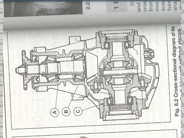

What does a Sierra LSD look like?
Hi,
Does anyone have a picture of the internals of a Sierra LSD?

Hi Graham,
The Sierra V6 Haynes manual shows cross sections of both types of diff. You can identify which one you are looking at from this.

Here you go. Without LSD:
![](/galpreviews/a148420-non_lsd.jpg) ![Rescued attachment non_lsd.jpg](/gallery/a148420-non_lsd.jpg) Rescued attachment non_lsd.jpg
