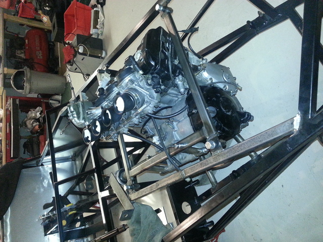

So onto the chassis mods for the engine swap.
Getting some sort of idea for engine position:
Picked up a prop shaft off here that was done by MK for a Busa eng,took a chance on it and I'm glad I can make it fit.
I was planning on making a cradle from scratch,but Danny from MK offered me one at a price that made making one myself seem daft!
Welded in the mounts for cradle and made up a bottom mount once the cradle was in a position I was happy with.
Also took the opportunity to move the factory fitted chassis number plate up onto the top bar I was welding in,and weld it on right around as from the factory it was only welded on with two spots.
Cut off the Zetec engine mounts too.

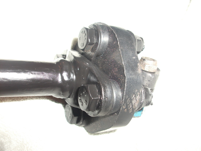

Refurbed this rusty old perished thing too!!
Given the same treatment as the hubs/calipers,and new bush kit off E-Bay:
