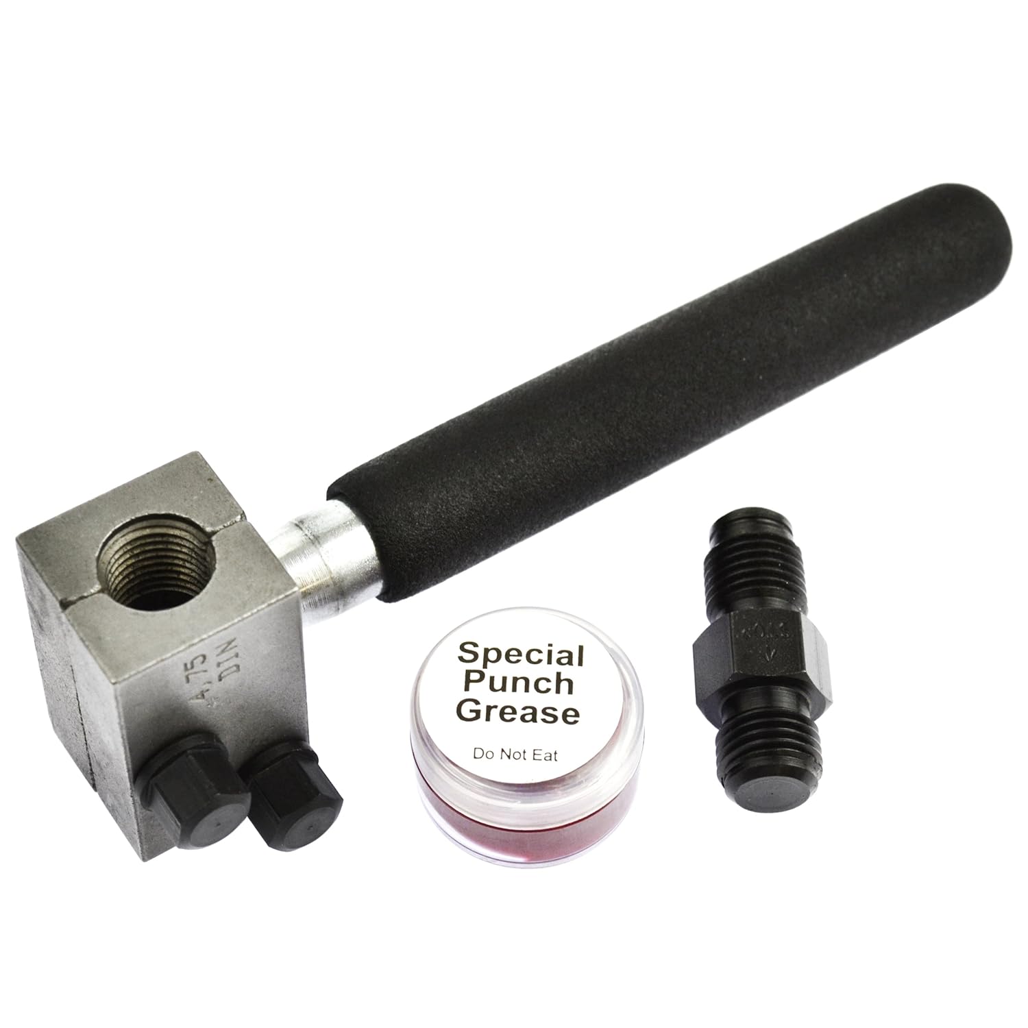

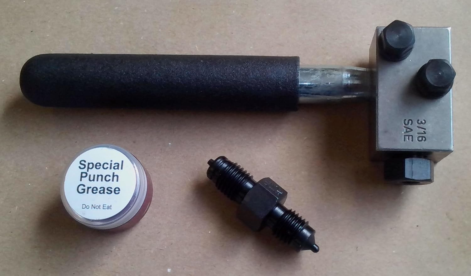

With the "Powerhand" tool, I've noticed that the DIN version of the tool just comes with a single flare "bolt" where the SAE comes with both a double and single "bolt"
Not sure if that means that DIN doesn't do double.

britishtrident
posted on 19/5/15 at 02:48 PM Reply With Quote
Din version definitely comes with a double ended press tool, something wrong with that one.

ken555
posted on 19/5/15 at 05:00 PM Reply With Quote
Even the YouTube video seems to suggest this.

scudderfish
posted on 19/5/15 at 07:34 PM Reply With Quote
The vid shows the single flare being done on the DIN tool and the double on the SAE. Hmmmmm........
