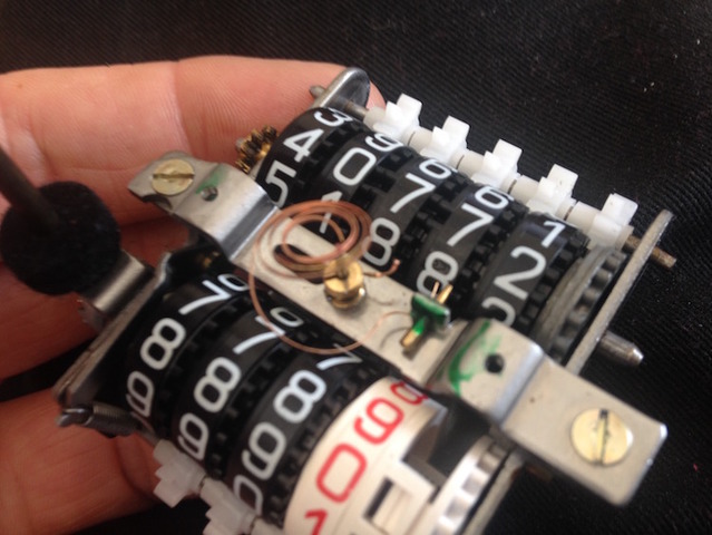

Eventually worked it out... needle was turning almost 1-1 with the cable movement, and not returning to zero.
Broken spring!?
Er, yup!
Oh well, anyone have a 80mm mechanical speedo they want to sell?

Posiible to solder a short length f wire to join the spring?
There are two companies in uk that come up with werb search that can refurb speedos, it may be possible to buy the spring from them.
