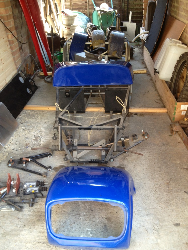

Hi everyone, I'm Mark from Suffolk, I am new to this so bare with me. I purchased this kit from a colleague a few years ago as he couldn't get the time to build it. I have only just got the motivation and space to start doing something with it myself. I am in the motor trade working for a main dealer but obviously this is not anything like repairing modern vehicles so this is all new to me.
I have been doing a lot or research (most on this site) trying to work out what fits what and what will work for me. I don't have a huge budget for this but don't see this as a problem as for me I would rather make/modify parts to do the job rather than off the shelf. I like the way you can build these and there is no right or wrong way to a point. I have also been reading through the IVA manual, I am an MOT tester but there is sooo much more to think about and could have without reading this overlooked some major points.
So far I believe it to be a Ron Champion design, it came with a pinto engine and I know a lot can be done with these engines but at a cost, also I wanted something more modern which for me makes the build more interesting. I am getting my 3 children aged between 5 and 9 involved where thay can. I decided I wanted a ST170 engine with a type 9 gearbox and 1.8 zetec flywheel. I have not decided what clutch plate and cover to use yet but thinking 2.0 pinto as these seem to cope with the power better from what I have read and hopefully fit after re drilling flywheel.
I will be using the original fuel system which will keep the cost down but will be a tight squeeze in sure. I will be after some advice along the way on this build and also some parts I have not got both I am hoping this will be the place to come to.
