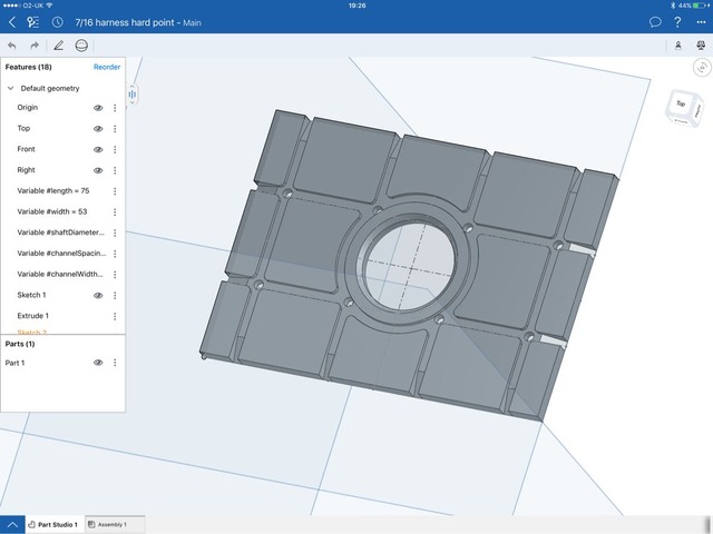

Hi All
Can anyone help with a short-run of some CNC milled parts I need - I'm making hard-points to go into my carbon tub. Material is 3mm thick mild steel, and I can supply files in more or less any format you need, and if there's something you would suggest about the design that makes milling easier, I'm open to changing the design.
I've got a picture here, and the dimensions are roughly 73x54mm. The channels and holes are 2mm wide and I need 14 off - 6 either side for the harnesses and a couple spare.

Can't do the work for you, but looking at your image it looks a complex part to CNC machine.
Are the grooves for air flow or maybe material to hold the part in place?
Would it be easier to make the part flat and bond it to the carbon tub - there are some pretty strong adhesives around these days!

Hi Nick - many thanks for the input.
This hard-point will be right in the middle of the CF stack and it will replace part of the 3mm core. When doing resin infusion you need to score the core with grooves and cross-drill where the grooves intersect. This then allows the resin to flow from the top of the stack where the flow mesh is, through the core (which would otherwise be a barrier) and down to the cloth underneath.
I then end up with something neat, and replacing core material, which makes it about as strong a hard-point as I could get. Finally, when it comes to demoulding, if I screw an adaptor I've made into the 7/16 threaded insert, I can use compressed air to force a release - far, far faster than trying to do it the traditional way.
I'm more than happy to drill the 2mm holes, and for the chamfered edges, I'd finish them with a dremmel if needs be.
If I were to boil the spec down to something with the grooves cut in, and the hole in the middle for the 7/16 insert, would that simplify it?
The grooves are 2mm wide and 1mm deep - just enough to guarantee a reasonable resin flow.
I'd settle for one single sheet of 3mm with just the grooves and circles cut in, and I could finish the rest myself - I could easily replicate the design for that.
Any suggestions you have for making this more machinable, let me know. Needless to say ... "resin infusion harness hardpoints" aren't something you can just buy from Merlin

I need really accurate control over the depth, and there's a circular groove in the middle that matters - the size of threaded insert is just too wide for the 20mm grooves I'm working to.
I can do it in a normal mill, but it will take a few hours. I'd sooner send it off and get it back. I was very surprised at the cost though - it struck me as way too high.

Wow, they are not the cheapest. They work on volume of order. What about 3d printing and casting. The cheapest option would be a local machinist.
FuryRebuild
posted on 17/2/17 at 08:27 PM Reply With Quote
Well, i can 3d print plastic at home, so no problem there. I think that would be a better option, as in get some printed to make a sand cast.
I'm thinking of just using my friend's mill to cut the 1mm groove and drill the rest. It may mean spending a day doing it, but that's worth 2k to me.
The other option is to go back to my original idea and one HowardB suggested, which is do them externally. I can still cast release-points for the airline into the mould but I can be utterly sure I have my harness points accurately in place.
I can then get the parts laser cut for peanuts, but I've also got some t45 sheet that's not really earning its keep, so I can use that. If I have the bonding face sand-blasted it will have a brilliant key when bonded in.

I'm not sure how much milling you've done, but a <3mm cutters are more like engraving type tooling. It wants to be running at ridiculous speeds to be cutting well or you'll be breaking endless tooling per part. Your feed rate is still going to be pedestrian in steel, so you might find you'd be at it for more than a day.
It's an interesting design idea, but the outside sandwich seems like a far more suitable plan for low volume. In volume, MIM (metal injection moulding) would probably be a better option given the detail, but the setup costs are prohibitive.

The machining time of those is going to be non trivial on anything other than a proper production CNC mill, i have a Wabeco bench top CNC mill and to make 14 of those is going to take quite some time esp if those grooves are only 2mm wide as that is a tiny bit, if they could be cut from plate on a CNC plasma cutter then I can help but I'm afraid I can't volunteer if they need to have those grooves milled in them.
The only problem with a plasma cutter is that it makes post machining difficult on steel as it basically nitride hardens the edges plus the tolerances are not what you can get from a mill.

Simple question, why mild steel and not ali? I'm sure that would bring the production cost down considerably. Also square corners are not great from a stress perspective for inserts, could you make it a round turned part with circular grooves, then just manually cut a few perpendicular joining grooves with a dremel?
