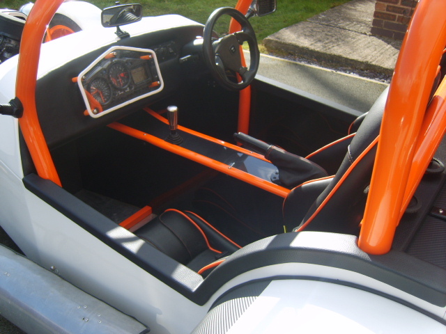

Here's one my mate has just done, not sure if it's IVA friendly or not?
Looks good though and uses standard CBR900 clocks!
I think I'll be copying when I get a new dash!
