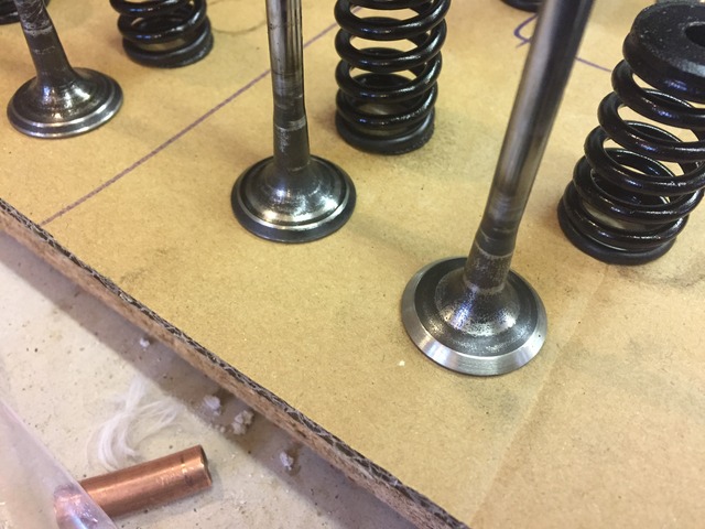

I've been messing about with a valve grinding setup on my lathe and have arrived at a pretty decent result. The setup uses a dremel mounted in the tool post with the slide angle setup to match the seat cutter i have.
The snag is that for the first couple of valves that i ground i hadnt realised that my 3 jaw chuck was putting the concentricity out by 5 thou - silly mistake i know.
As i dont have a collet set im now using a 4 jaw and setting up each valve.
To finish the job off i would love the chance to replace the first 3 which i have ground 5 thou out on run-out.

A few photos of what i have been doing:
[img] Tool Post Grinder
Tool Post Grinder
[/img]
[img] Before & After
Before & After
[/img]
[img] Lapped
Lapped
[/img]
