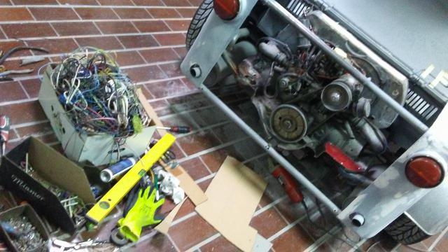

First attempt of engine cover;
Second version under construction;
Cooling turbine resized and exits for heating blocked...here in Dalmatia we do not need that

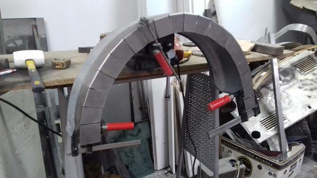

third version of engine cover...first is ugly,second nicer but twisted third have solid corners and door in center,stronger structure and must be better solution...

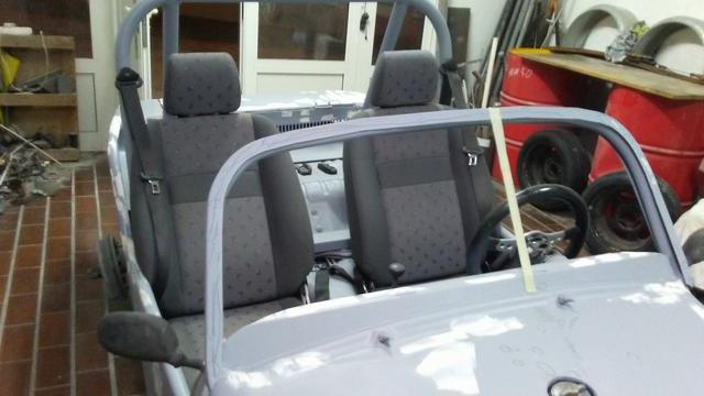

Summer is gone,kids are in school...time for "Yolande"
Seats are from '08. Hyundai,Seat belts from '98.Fiat Uno,outside mirrors from some scooter /cut and adapt/...too much small jobs for a little free time

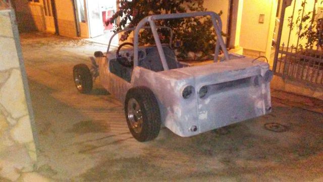

you've done very well the essence of the locost is certainly there and looks much more fun than the original beetle. With such tight laws your car will no doubt stand out from the crowd. Looking forward to seeing it finished
My only question is... are you remembering how the rear suspension works?? yours looks like the original swing axle version and so when the rear is loaded up, like when going round a corner, the wheels will tilt in at the top and it looks like you have very little clearance between the wheel & body work.Certainly not enough for that kind of suspension.
[Edited on 9/10/18 by Mr Whippy]
View User's Profile Visit User's Homepage View All Posts By User U2U Member   Mr+Whippy 's Aim
zoranR
posted on 9/10/18 at 01:10 PM Reply With Quote
Thank you for advice but alu Slot mags are 20 mm deeper of this rims on last picture so gap between wheel and body will be o.k.

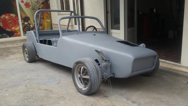

some works;
posted on 12/3/19 at 07:30 AM Reply With Quote
Wow that is coming on great and the bodywork looks very impressive
You've certainly put in a lot of hard work and a huge heap of imagination into it.
Seems almost ready for painting
Can't wait to see this once finished

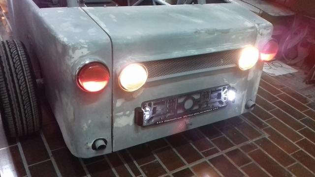

zoranR
posted on 13/3/19 at 08:08 PM Reply With Quote
today,one hour free time.. clean amateur welding and check...
Some stupid people wrote traffic law in Croatia.
Thew said;...on front 1/3,behind 2/3 of tire must be covered with mudguard...like we live with no asphalt...
