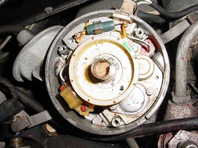

r1_pete
posted on 15/4/18 at 10:41 PM Reply With Quote
This is the bad boy of the rv8 distributors, loads of problems, cracked boards, dry solder joints, etc etc very susceptable to engine temperature.
35DE8
35DE8
Agriv8
posted on 17/4/18 at 01:09 PM Reply With Quote
Sometimes called the 'Opus' and very often called the Hop'l'us system mine would be the same certain temp then it would cut out and die !
