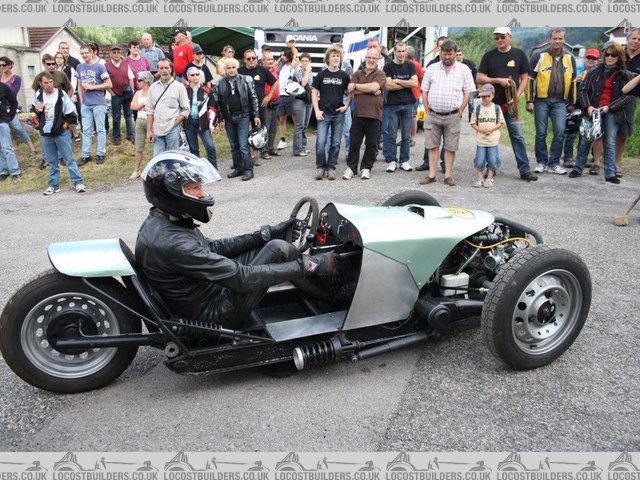

I have always had the BMW trike idea in my mind. I saw this online - 2CV based but fancied a BMW version:
[img] Three wheels 1
Three wheels 1
[/img]
I also saw this at Stoneleigh 2 years ago - the owner is on a Facebook three wheeler page I follow!
[img] Three wheels 2
Three wheels 2
[/img]
Was thinking of ordering a Triking....may delay that now!!
