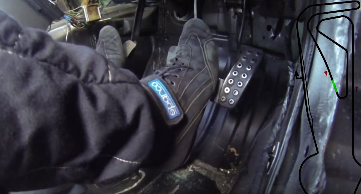

That sounds 'about' right - but 'about right' makes it tricky IME. You need to have the pedal setup spot on when learning or it becomes harder. You need to have confidence you can provide full braking without accidentally prodding the throttle too, but the throttle needs to be right there when you want it.
Personally I hate driving in racing shoes, they give such little feel, but if that's what you need to use because of your huge feet then so be it
Consider adjusting your pedals so the throttle and brake almost overlap - considering what I said above. You can see the extra bit on my throttle here (really old video, not very good technique but you get the idea). Without the extra plate it would be difficult to heel-toe well.

posted on 21/9/18 at 06:45 AM Reply With Quote
Hi Adam,
Thanks for the pic, yeh thatís my problem is I need tiny shoes to drive the car, but find the gap between brake and throttle to big to use the side of my foot.
Iíll have a play with pedal position
