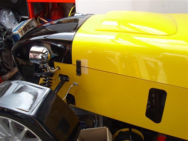

Hello!
I am currently packaging my headlight and indicator looms and I was wondering how you guys attached then to the mounts for IVA? My light mounts are made of 3/4 inch tube.
Tiewraps are a no-no because of radius rules, so what's the best way to make sure their secured but also not going to fair l IVA?
All ideas welcome
Josh

I used shower hose and tight grommets, the shower hose is stainless and has a ptfe liner, and is cheap as chips
posted on 20/5/19 at 11:17 AM Reply With Quote
SVA not IVA, but I used split tubular plastic corrugated conduit over my headlamp wires.
GENIUS! That is a brilliant idea.
