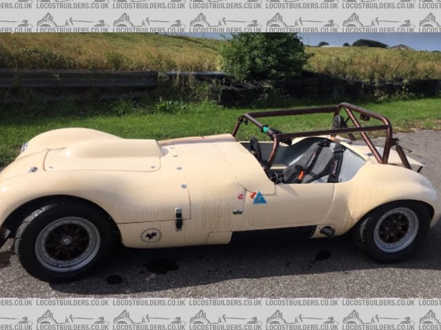

posted on 24/9/19 at 04:40 PM Reply With Quote
Originally posted by JekRankin
Sounds like a lucky escape!
Jek
Oil
Oil
If you look closely, youíll see the oil all over it.
Once the clean-up was done, I found a local hardware store and bought 4 jubilee clips for the ďno clips needed, push-on hosesí which got me through the afternoon. Iíve since been an had nice new seated braided lines made at Pirtek.
